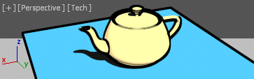

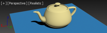

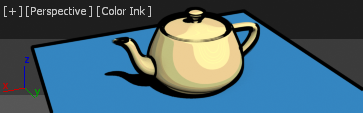

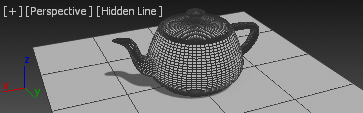

<ViewportViewSettingImpl>.VisualStyleMode : enum : Read|Write
VisualStyleMode enums: { #Realistic | #Shaded | #ConsistentColors | #HiddenLine | #Wireframe | #BoundingBox | #Clay | #Ink | #ColorInk | #Acrylic | #Tech | #Graphite | #ColorPencil | #Pastel }
Get/set the Viewport's Visual Style, including realistic, shaded and non-photorealistic modes. The property can be set as enum name or integer value. When getting, it will return the enum name.
Some of these options are not available in the Per-View Preferences dialog, but rather under the Stylized menu in the Per-View Preference Viewport Label Menu.
As of 3ds Max 2021.3 Update the #Shaded mode is no longer supported.

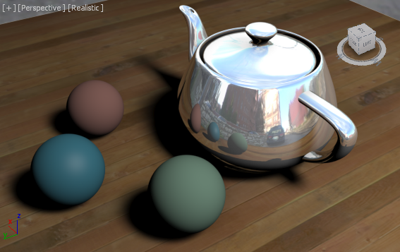

Possible values are:
| Numeric Value | Enum Name | UI Name | Example |
| 0 | #Realistic |
Default Shading Mode | ![]() |

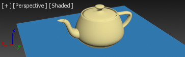

| 1 | #Shaded |
Shaded | ![]() |
| 2 | #Facets |
Facets | ![]() |

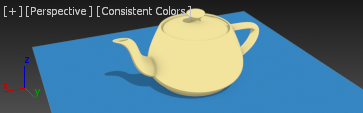

| 3 | #ConsistentColors |
Flat Color | ![]() |
| 4 | #HiddenLine |
Hidden Line | ![]() |

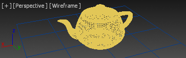

| 5 | #Wireframe |
Wireframe Override | ![]() |

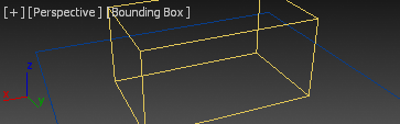

| 6 | #BoundingBox |
Bounding Box | ![]() |

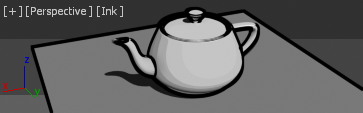

| 7 | #Ink |
Ink | ![]() |
| 8 | #ColorInk |
Color Ink | ![]() |

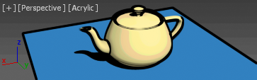

| 9 | #Acrylic |
Acrylic | ![]() |

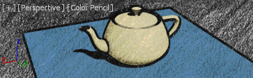

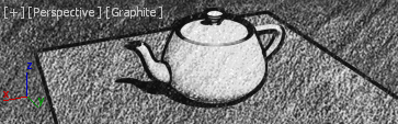

| 10 | #Tech |
Tech | ![]() |
| 11 | #Graphite |
Graphite | ![]() |

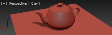

| 12 | #ColorPencil |
Color Pencil | ![]() |
| 13 | #Pastel |
Pastel | ![]() |
| 14 | #Clay |
Clay | ![]() |
| 15 | #ModelAssist |
Model Assist |

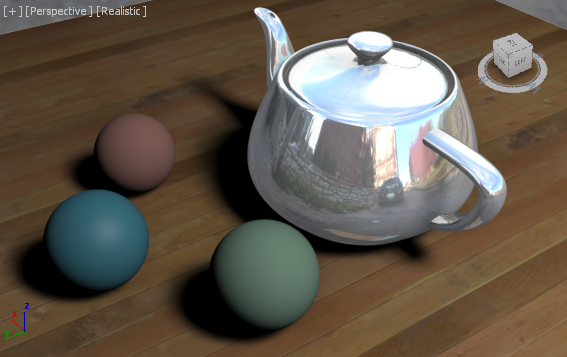

<ViewportViewSettingImpl>.ReflectionEnabled : boolean : Read|Write
Get/set the state of the "Reflection From Environment" checkbox.

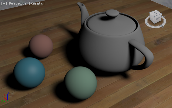

<ViewportViewSettingImpl>.DynamicReflectionEnabled : boolean : Read|Write
Get/set the state of the dynamic reflections option (currently not exposed to the UI).
When set to True, Materials with a Raytrace or Reflect/Refract map in their Reflection map slot will calculate dynamic reflections of the surrounding scene objects if switched to "Show Realistic Material In Viewport" mode.
When set to False (default), no dynamic reflections will be calculated.
| Reflection Properties | Result | Notes |
.ReflectionEnabled=off |
When .ReflectionEnabled is off, the state of .DynamicReflectionEnabled is ignored. |
.ReflectionEnabled=on``.DynamicReflectionEnabled=off |
When .ReflectionEnabled is on, Environment Reflection Maps are shown if the Material has a Reflection Map and Show Realistic Material In Viewport is on. |
.ReflectionEnabled=on``.DynamicReflectionEnabled=on |
When both properties are on, both Environment Reflection Maps and Scene Objects will be reflected. No reflections of reflections will be calculated though.Reflections will look correct only on curved surfaces. |
