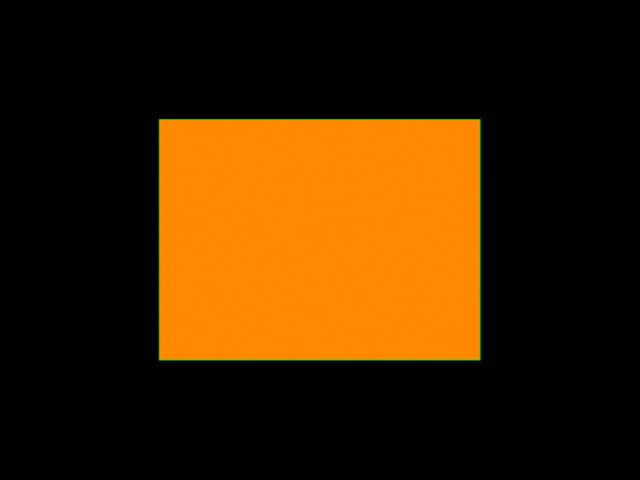

SIMPLEST EXAMPLE:
<svg  xmlns="http://www.w3.org/2000/svg"
      xmlns:xlink="http://www.w3.org/1999/xlink">
    <rect x="255" y="255" height="512" width="512"
          style="stroke:#ff8800; fill: #0000aa"/>
</svg>

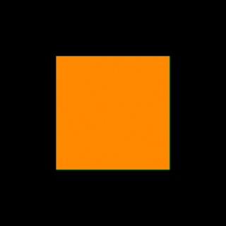

Save this code in a new text file under the name "Rectangle.svg" in your 3ds Max UserScripts folder.
Then create a Vector_Map TextureMap and load this code as the Vector File.
Then render the resulting map into bitmaps with different resolutions - 160x160, 320x320 and 640x320.
You can do this manually, or using MAXScript:
theSVGMap = VectorMap()
theSVGMap.vectorfile = GetDir #userscripts + "\\rectangle.svg"
for i in #([160,160], [320,320], [640,480]) do
  display (renderMap theSVGMap size:i filter:true)
Evaluating the above MAXScript will render 3 images with different resolutions from the same scalable graphics definition.
Here are the resulting images:

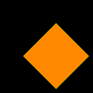

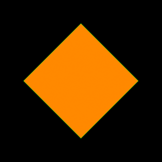

Applying Transformations
Let's rotate the rectangle that we created at 45 degrees about its center.
TRANSFORMATIONS EXAMPLE:
          transform="rotate(45 511 511)" />
</svg>
Re-save this code in the same text file under the name "Rectangle.svg" in your 3ds Max UserScripts folder.
Update the Vector_Map either manually in the Material Editor, or via MAXScript using theSVGMap.reload()
Render the resulting map into a bitmap with resolutions of 320x320.
theSVGMap.reload()
display (renderMap theSVGMap size:[320,320] filter:true)
Evaluating this script will render the scalable graphics definition and display the bitmap.
Here are the resulting image:

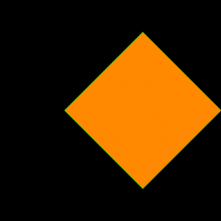

Let's also translate the shape 150 units along X before we have rotated it.
When multiple transformations are specified, each one modifies the current coordinate system in the given order:
          transform="translate(150) rotate(45 511 511)" />
</svg>
Saving the SVG definition and running the same MAXScript as above produces the following:
In the above case, the translation was applied before the rotation, so the coordinate system was first shifted to the right, then the rotation was performed.
If we were to specify the Translation after the rotation, the rotation will occur first, then the translation will occur in the already rotated coordinate system.

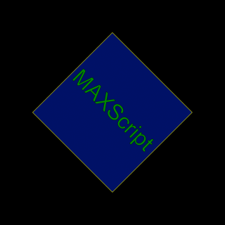

Creating Text
TEXT EXAMPLE:
    style="stroke:#ffff00; fill:#001166">
  </rect>
  <text x="255" y="255"
    transform="rotate(45 511 511) translate(15 280)"
    style="stroke:#000000; fill:#008800; font-size:100; font-family:Arial">
    MAXScript
  </text>
</svg>
Save this code in a new text file under the name "RectangleText.svg" in your 3ds Max UserScripts folder.
Run the following MAXScript.
theSVGMap.vectorfile = GetDir #userscripts + "\\RectangleText.svg"
Evaluating this script will render the following image:

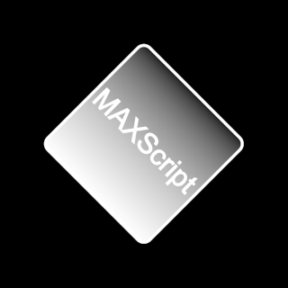

Defining Gradients, Stroke Width And Corner Radii
Instead of filling the shape with a solid color, we could define a named Gradient and use it in place of the color for the rectangle's fill: parameter.
This Gradient will have the id "LinearGradient" and will interpolate linearly along the Y axis from a dark blue color with zero opacity to a brighter blue color with full opacity.
In the Rectangle's definition, we will use the id "LinearGradient" to pass this definition to the fill: parameter.
We will also set the corner radii to 30 units and the stroke width of both the rectangle and the text to 3 units.
GRADIENT EXAMPLE:
  <defs>
    <linearGradient id="LinearGradient1"
      x1="0%" y1="0%"
      x2="0%" y2="100%"
      spreadMethod="pad">
      <stop offset="0%"   stop-color="#001166" stop-opacity="0"/>
      <stop offset="100%" stop-color="#0055aa" stop-opacity="1"/>
    </linearGradient>
  </defs>
  <rect x="255" y="255" height="512" width="512" rx="30" ry="30"
    style="stroke:#ffff00; fill:url(#LinearGradient1); stroke-width: 10">
  </rect>
    style="stroke:#000000; stroke-width:3; fill:#008800; font-size : 100; font-family:Arial">
    MAXScript
  </text>
</svg>
Save this code in a new text file under the name "RectangleGradientAndText.svg" in your 3ds Max UserScripts folder.
Run the following MAXScript. We are now rendering into a pre-created bitmap in order to produce a correct Alpha channel.
theSVGMap = VectorMap alphasource:0 --enable Alpha
theSVGMap.vectorfile = GetDir #userscripts + "\\RectangleGradientAndText.svg"
theImage = bitmap 320 320 --create a bitmap with the desired size
renderMap theSVGMap into:theImage filter:true --render into that bitmap
display theImage --display the bitmap
Evaluating this script will render the following image, and the alpha channel will reflect correctly the gradient's varying opacity:

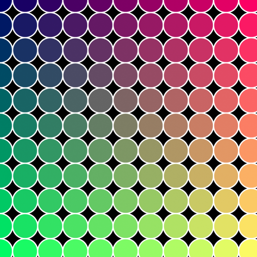

Generating SVG Files Using MAXScript
Instead of typing the SVG text files by hand, we can employ MAXScript's ability to write ASCII Text Files to create SVG files procedurally.
For example, let's create a function for outputting a circle with specific radius and colors at a user-defined position and call that function multiple times using MAXScript FOR loops.
We will also need a function to convert a MAXScript color value to a Hexadecimal color value as used by XML and HTML.
Note: 'Single quotes' can be used in place of "double quotes" inside the SVG file - this makes the MAXScript output easier since we don't have to escape them as \"
EXAMPLE:
--The following function converts a MAXScript color value to a Hexadecimal color value
fn ColorToHex col =
    theComponents = #(bit.intAsHex col.r, bit.intAsHex col.g, bit.intAsHex col.b)
    theValue = "#"
    for i in theComponents do
        theValue += (if i.count == 1 then "0" else "") + i
    theValue
--The following function outputs a basic circle definition to a given SVG file:
fn createSVGCircle SVGFile pos radius:100 stroke:yellow fill:red thick:1 =
    format "<circle cx='%' cy='%' r='%' \n" pos.x pos.y radius to:SVGFile
    format "\tstyle='stroke:%; fill:%; stroke-width:%' >\n" (ColorToHex stroke) (ColorToHex fill) thick to:SVGFile
    format "</circle>\n" to:SVGFile
theSVGFilename = GetDir #userScripts + "\\Circles.svg" --Define an output file name
theSVGFile = createFile theSVGFilename --Create a text file
format "<svg xmlns=\"http://www.w3.org/2000/svg\"\n" to:theSVGfile --Output the SVG header lines
format "\t\txmlns:xlink=\"http://www.w3.org/1999/xlink\">\n" to:theSVGfile
theStep = 100 --This is the step in pixels along both X and Y
for y = 0 to 1024 by theStep do --Loop along Y and X with the given Step
    for x = 0 to 1024 by theStep do --and create circles with position and fill color based on the loops:
        createSVGCircle theSVGFile [x,y] radius:(theStep/2) stroke:white fill:(color (x/4) (y/4) 100) thick:5
format "</svg>\n" to:theSVGfile --End of the SVG body definition
close theSVGfile --Close the file
theSVGMap = VectorMap() --Create a new Vector_Map instance
theSVGMap.vectorFile = theSVGFilename --Assign the output file to the new map
display (renderMap theSVGMap size:[512,512] filter:true) --Render the map at 512 resolution and display
Here is the resulting map rendered as image:

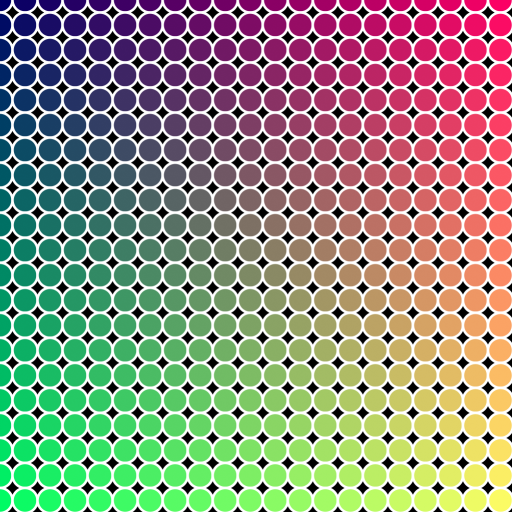

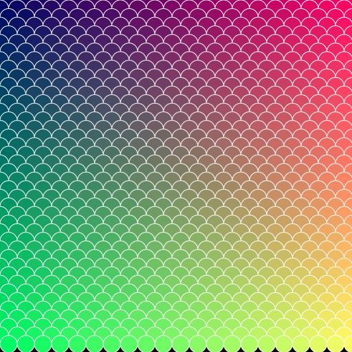

By just changing theStep variable from 100 to 50, we can easily produce more and smaller circles:
Let's modify the loop further - we can shift every second row by half the step to the side and reduce the Y loop to use half the step.
We will also use a Stroke Thickness of 2 to produce finer outlines:
--Partial Code Fragment - insert in the above script!
theStep = 50
cnt = 0 --introduce a counter variable
for y = 0 to 1024 by theStep/2 do --divide the vertical step by two
    cnt = 1-cnt --change the counter between 0 and 1 after each row
    for x = 0 to 1024 by theStep do --shift the X by half the step multiplied by the counter (0 or 1):
        createSVGCircle theSVGFile [x+(theStep/2*cnt),y] radius:(theStep/2) stroke:white fill:(color (x/4) (y/4) 100) thick:2
--End Code Fragment
The result looks like scales!

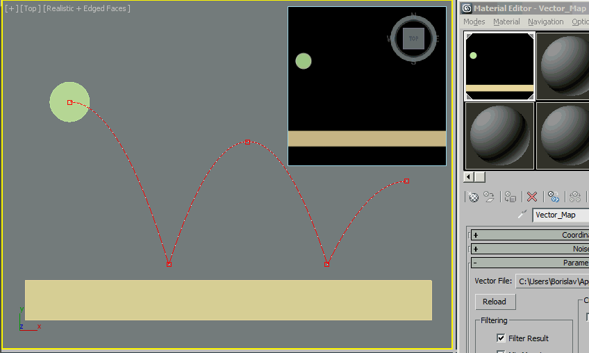

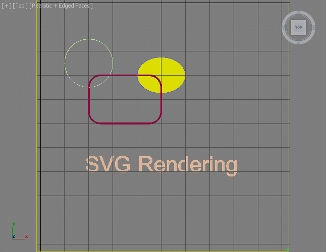

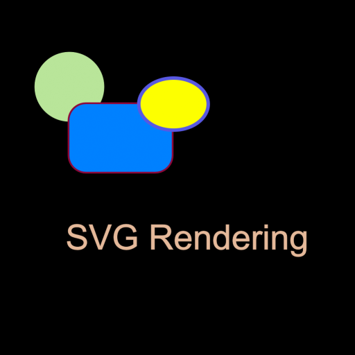

Including Static Scene Properties
Since MAXScript can easily read properties of scene objects, we could output scene geometry (for example spline shapes) to SVG and thus turn the 3ds Max viewports into a simple SVG Editor!
For example, we can take the Circle drawing function above and implement similar functions for the other typical shapes including Rectangle, Ellipse etc.
Then, we can run through the 3ds Max scene and when we encounter a matching spline primitive, we can grab its properties and output to the SVG file.
EXAMPLE:

Here is a screenshot of a scene containing a green Circle, a dark red Rectangle, a purple Ellipse and an orange Text shape.
The Circle has a Radius of 100 and no material or modifiers.
The Rectangle is 300x200 units and has Corner Radius of 50; its Renderable property checked, has a Thickness of 5 and a Standard Material with blue diffuse color assigned.
The Ellipse with size 200x150 has its Thickness set to 10, a MeshSelect modifier on the stack, and has a yellow Standard Material assigned.
The Text has no material and a MeshSelect modifier on the stack.
These objects were placed in the bottom right quadrant of the World Origin, so that their Y coordinates are negative, with the origin in the upper left corner. A green Point Helper shows the position of the 1023,1023 coordinate.
Running the above script produces the following image:
Note that the order of object creation was reflected in the order of shape drawing. The stroke color was taken from the wireframe (object) color; the fill color was taken from the Standard Material's diffuse color, or from the wirecolor property when there was no Material. The Renderable Thickness property was also respected.

ANIMATED SVG EXAMPLE:
<rect x='0.0' y='800.0' width='1024.0' height='100.0'
    style='stroke:#e4d699; fill:#e4d699; stroke-width:1.0' >
</rect>
<ellipse cx='mxs(at time currentTime $Ellipse001.pos.x as string)'
    cy='mxs(at time currentTime (-$Ellipse001.pos.y) as string)'
    rx='mxs(at time currentTime ($Ellipse001.width/2) as string)'
    ry='mxs(at time currentTime ($Ellipse001.length/2) as string)'
    style='stroke:#ffffff; fill:#b8e499; stroke-width:3.0' >
</ellipse>
</svg>
Saving the above SVG file and loading it with a Vector_Map will produce an animated texture following the Position and Radius animation of an Ellipse001 object in the scene.
Assigning that Vector_Map texture to the Diffuse channel of a Standard Material and assigning it to a Plane produces a dynamic real-time rendering "screen" in the viewport showing the same animation. In addition, the Map display in the Material Editor will also render and show the animation:
