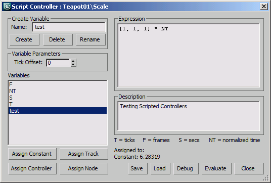

User-Defined Variables
A script controller supports four types of user-defined variables: Constant, Target, Object, and Node. The main difference between these variables is the type of value or reference they contain, which in turn determines the type of notification messages that will cause an update of the script controller.
Note that in the Script Controller UI, the creation of the variable and the assignment of the value is performed in two separate steps (the Create button always creates a Constant Variable with a value of 0) while in MAXScript, the creation and assignment are performed in a single step.
Constant Variable
A constant variable can contain a constant value.
The MAXScript Expression assigned to the variable will be evaluated and if the return value is a constant, it will be used as the value of the variable. The constant variable creates no dependencies on other objects.
If the expression evaluates to a MAXWrapper (such as, a node, material, modifier, controller, and others), the result will be stored in an Object variable and will be updated dynamically. In other words, the .addConstant() method will behave like the .addObject() method and the resulting variable will not be a Constant variable, but an Object variable.
If the result of the expression evaluation is a subAnim, it will be stored as a Target variable. In other words, in this case .addConstant() will behave like the .addTarget() method.
<boolean>AddConstant <string>Name <value>Constant
Adds a constant variable to the controller. Corresponds to the "Create" and"Assign Constant" buttons in the Script Controller UI.
A constant variable returns the value of the MAXScript expression assigned to it. The expression can be any valid MAXScript expression that evaluates to a value.
The first argument is the name of the constant variable.
The second argument is the expression to be assigned to the variable.
Returns true on success, false on failure.

EXAMPLE
obj = Teapot ()
-->$Teapot:Teapot01 @ [0.000000,0.000000,0.000000]
obj.scale.controller=scale_script ()
-->Controller:Scale_Script
obj.scale.controller.addConstant "test" (pi*2)
-->true
obj.scale.controller.getValue"test"
-->6.28319
obj.scale.controller.getValue"test2"
-- Runtime error: IScriptCtrl::GetVarValue - Bad Index or name: "test2"

obj.scale.controller.getValue 1--Time in Ticks
-->160.0
obj.scale.controller.getValue"T"--Time in Ticksaccessed by Name
-->160.0
obj.scale.controller.getValue 2--Time in Seconds
-->0.0333333
obj.scale.controller.getValue"S"--Time in Secondsaccessed by Name
-->0.0333333
obj.scale.controller.getValue 3--Time in Frames
-->1.0
obj.scale.controller.getValue"F"--Time in Framesaccessed by Name
-->1.0
obj.scale.controller.getValue 4--Normalized Time in Range 0-100
-->0.01
obj.scale.controller.getValue"NT"--Normalized Timeby Name
-->0.01
obj.scale.controller.getValue 5--User Constant Variable
-->6.28319
obj.scale.controller.getValue"test"--User Constant by Name
-->6.28319
obj.scale.controller.getValue"sunPos"--User Constant by Name
-- Runtime error: IScriptCtrl::GetVarValue - Bad Index or name: "sunPos"
obj.scale.controller.renameVariable"test" "someValue"--Rename...
-->true
obj.scale.controller.getValue"someValue"--User Constant by New Name
-->6.28319

Expression
The Expression is the MAXScript Expression evaluated by the script controller to determine its final value.
<boolean>SetExpression <string>Expression
Sets the expression string of the script controller to the string passed by-reference.
Returns true on success, false otherwise.
<string>GetExpression ()
Returns the script controller's expression string.
<void>Update()
Updates the controller by reevaluating its expression.
Description and Details
The Description is a user-defined string value describing the features and functionality of the script to be read by other users of the 3ds Max scene containing the controller.
<string>GetDescription ()
Returns the description string.
<boolean>SetDescription <string>Description
Sets the description string.
<string>PrintDetails ()
Prints information about the script controller, including the description string, expression code, and variable details.
