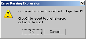

Close button - Compiles and checks the controller script for errors. If no errors are found, it closes the dialog. If an error is detected, a MAXScript error message is shown first with the description of the problem. After closing the error message, a prompt appears asking whether to revert the expression to the original value of the current track and close the dialog (OK) or to return to editing the expression (Cancel):
