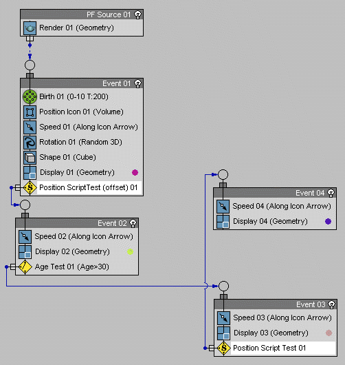

The following example uses Script_Test actions to implement scripted position tests with both relative offset and absolute position options.
Can Be Used With:
The two scripts must be used inside the Script_Test : Helper actions.
Effect:

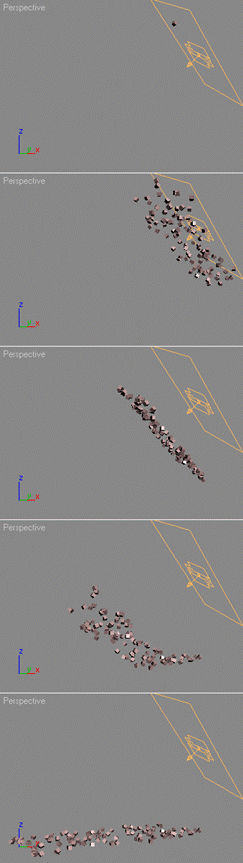

  • The PF_Source generates particles which get tested for relative offset of -100 to their birth position along the Z axis.
  • If they pass the scripted offset test, the particles are moved to the second Event which stops them and tests them for Age above 30.
  • If they pass the Age Test, the particles are moved to the Third event which tests them for absolute offset of -200 along the world Z axis using the second script.
  • If they pass the scripted position test, the particles are moved to the last Event which stops them.
