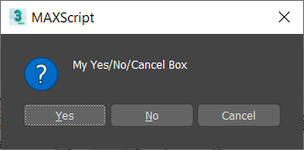

yesNoCancelBox <message_string> [optional arguments - see below]
Displays a modal message with Yes, No, and Cancel buttons. The yesNoCancelBox()
function returns #yes
, #no
or #cancel
depending on which button the user selects.

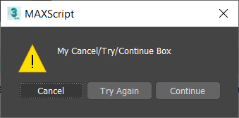

cancelTryContinueBox <message_string> [optional arguments - see below]
Displays a modal message box with Cancel, Try Again, and Continue buttons. This dialog returns #cancel
, #tryAgain
, or #continue
, depending which button the user selects. Available in 3ds Max 2020.1 Update and higher.

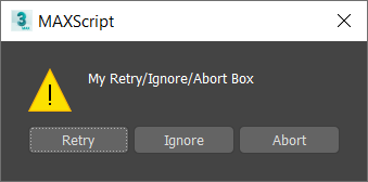

retryIgnoreAbortBox <message_string> [optional arguments - see below]
Displays a modal message box with Retry, Ignore, and Abort buttons. This dialog returns #retry
, #ignore
, or #abort
, depending on which button the user selects. Available in 3ds Max 2020.1 Update and higher.
