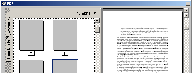

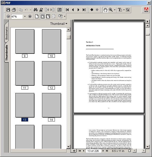

The following example will not work unless the PDF ActiveX control is registered on your system.
Properties
.src : string
Get/Set the source PDF file.
Methods
.LoadFile fileName:string
Load a new PDF file.
.setShowToolbar On:Boolean
When the argument is false, the toolbar will be hidden. When the argument is true, the toolbar will be displayed.
