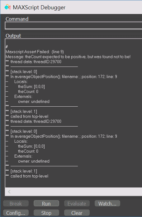

EXAMPLE:
In the following example, the function loops through all objects in the scene and accumulates their positions. At the end, it divides the resulting value by the number of objects to calculate the average position.
The script developer has assumed that the scene will never be empty, thus the final result would be a valid position. If the number of objects is zero, the division by zero would not crash the program, but would produce a Point3 value of[-1.#IND,-1.#IND,-1.#IND].
fn averageObjectPosition =
 theSum = [0,0,0]
 theCount = objects.count
 for i = 1 to theCount do
  theSum += objects[i].pos
 assert (theCount > 0) message: "theCount expected to be positive, but was found not to be!" options:#(#all) showstack:true
 theSum /= theCount
averageObjectPosition()
The developer has opted to include an assert() call, which postulates that theCount is expected to be always greater than zero and if that is not the case, the execution of the code will break in the debugger and will show the stack in the Listener.
In this example, this is done for demonstration and to illustrate how the assert() function works.
In real world, the assert() would be typically used to ensure the correctness of values going through much more complex calculations where catching irregularities with IF tests would be difficult because the developer cannot anticipate what can be the possible cases to test. In addition, the assert() has several report modes that could be useful (like breaking in the C++ Debugger when running a Debug build of 3ds Max).
If the above function is executed with an empty scene, the result would be
