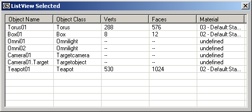

RESULT:

Using the Script
After evaluating the script, you will find a new ActionItem in the "HowTo" category of the Customize User Interface dialog. Assign it to a toolbar, menu, QuadMenu or keyboard shortcut to be able to access it quickly.
Select some scene objects and press the button/select the menu item or press the keyboard shortcut - a new dialog with a listView ActiveX control displaying the name, class, vertex and face count and assigned material should appear.
Select some other object and call the script again - the old dialog will be closed, a new one will be opened and will display the data of the new selection.
