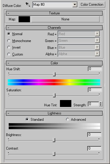

The Color_Correction TextureMap introduced in 3ds Max 2009 provides means to change the color information of an input texture map including Color Channel Rewiring, Brightness, Contrast, Hue, Saturation and Exposure adjustments and more.
Constructors:
Color_Correction...
ColorCorrection...
Properties:
<Color_Correction>.color Color default: (color 0 0 0) -- fRGBA color; Color_1;
Get/set the map's color used when no input map has been specified.
<Color_Correction>.Map UndefinedClass default: undefined -- texturemap;
Get/set the input map to color-correct.
Channels Rollout
<Color_Correction>.rewireR Integer default: 0 -- integer;
Get/set the Red= drop-down list index.
Possible values are:
0 - Red
1 - Green
2 - Blue
3 - Alpha
<Color_Correction>.rewireG Integer default: 1 -- integer;
Get/set the Green= drop-down list index.
0 - Red
1 - Green
2 - Blue
3 - Alpha
<Color_Correction>.rewireB Integer default: 2 -- integer;
Get/set the Blue= drop-down list index.
0 - Red
1 - Green
2 - Blue
3 - Alpha
<Color_Correction>.rewireA Integer default: 3 -- integer;
Get/set the Alpha= drop-down list index.
0 - Red
1 - Green
2 - Blue
3 - Alpha
<Color_Correction>.rewireMode Integer default: 0 -- integer; Rewire_Mode
Get/set the Rewire Mode.
0 - Normal
1 - Monochrome
2 - Invert
3 - Custom
Color Rollout
<Color_Correction>.hueShift Float default: 0.0 -- float;
Get/set the Hue Shift value.
<Color_Correction>.saturation Float default: 0.0 -- float;
Get/set the Saturation value.
<Color_Correction>.tint Color default: (color 0 0 0) -- fRGBA color; Hue_Tint;
Get/set the Hue Tint value.
<Color_Correction>.tintStrength Float default: 0.0 -- float; Hue_Strength;
Get/set the Hue Tint Strength value.

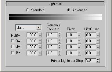

Lightness Rollout
<Color_Correction>.Lightness mode Integer default: 0 -- integer;
Get/set the Lightness Mode.
Possible values are
0 - Standard
1 - Advanced
Standard Mode Controls
<Color_Correction>.brightness Float default: 0.0 -- float;
Get/set the Brightness value in Standard mode.
<Color_Correction>.contrast Float default: 0.0 -- float;
Get/set the Contrast value in Standard mode.
Advanced Mode Controls
<Color_Correction>.exposureMode Integer default: 0 -- integer; Lightness;
Get/set theExposure Mode drop-down list's selection index.
0 - Gain
1 - F-Stops
2 - Printer Lights
<Color_Correction>.enableR BooleanClass default: false -- boolean;
Get/set the state of the R checkbox in Advanced Lightness mode.
<Color_Correction>.enableG BooleanClass default: false -- boolean;
Get/set the state of the G checkbox in Advanced Lightness mode.
<Color_Correction>.enableB BooleanClass default: false -- boolean;
Get/set the state of the B checkbox in Advanced Lightness mode.
Gain
<Color_Correction>.gainRGB Float default: 100.0 -- float; LightnessGainRGB;
Get/set the Gain RGB value in Advanced Lightness mode.
<Color_Correction>.gainR Float default: 100.0 -- float; LightnessGainR;
Get/set the Gain R value in Advanced Lightness mode.
<Color_Correction>.gainG Float default: 100.0 -- float; LightnessGainG;
Get/set the Gain G value in Advanced Lightness mode.
<Color_Correction>.gainB Float default: 100.0 -- float; LightnessGainB;
Get/set the Gain B value in Advanced Lightness mode.
Gamma/Contrast
<Color_Correction>.gammaRGB Float default: 1.0 -- float; LightnessGammaRGB;
Get/set the Gamma RGB value in Advanced Lightness mode.
<Color_Correction>.gammaR Float default: 1.0 -- float; LightnessGammaR;
Get/set the Gamma R value in Advanced Lightness mode.
<Color_Correction>.gammaG Float default: 1.0 -- float; LightnessGammaG;
Get/set the Gamma G value in Advanced Lightness mode.
<Color_Correction>.gammaB Float default: 1.0 -- float; LightnessGammaB;
Get/set the Gamma B value in Advanced Lightness mode.
Pivot
<Color_Correction>.pivotRGB Float default: 1.0 -- float; LightnessPivotRGB;
Get/set the Pivot RGB value in Advanced Lightness mode.
<Color_Correction>.pivotR Float default: 1.0 -- float; LightnessPivotR;
Get/set the Pivot R value in Advanced Lightness mode.
<Color_Correction>.pivotG Float default: 1.0 -- float; LightnessPivotG;
Get/set the Pivot G value in Advanced Lightness mode.
<Color_Correction>.pivotB Float default: 1.0 -- float; LightnessPivotB;
Get/set the Pivot B value in Advanced Lightness mode.
Lift/Offset
<Color_Correction>.liftRGB Float default: 0.0 -- float; LightnessLiftRGB;
Get/set the Lift/Offset RGB value in Advanced Lightness mode.
<Color_Correction>.liftR Float default: 0.0 -- float; LightnessLiftR;
Get/set the Lift/Offset R value in Advanced Lightness mode.
<Color_Correction>.liftG Float default: 0.0 -- float; LightnessLiftG;
Get/set the Lift/Offset G value in Advanced Lightness mode.
<Color_Correction>.liftB Float default: 0.0 -- float; LightnessLiftB;
Get/set the Lift/Offset B value in Advanced Lightness mode.
Printer Lights
<Color_Correction>.printerLights Float default: 5.0 -- float; LightnessPrinter;
Get/set the "Printer Lights Per Stop" value in Advanced Lightness mode.
