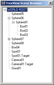

RESULT:

fn fillInTreeView tv = (
This function will define the content of the TreeView.
theRoot = tv.Nodes.add()
We add a single new node to represent the Root.
theRoot.text = "WORLD ROOT"
We set its label to "WORLD ROOT"
rootNodes = for o in objects where o.parent == undefined collect o
Then we collect all objects in the scene that have no parent. These are the top-level nodes that will be the "children of the world".
addChildren tv theRoot rootNodes
Finally, we call the recursive function, passing the TreeView, the Root node and the array of top-level scene objects as arguments.
