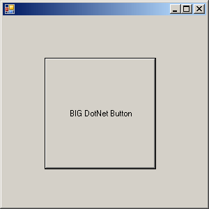

DotNet controls cannot only be placed inside 3ds Max Dialogs and Rollouts, but they can also be used to generate user interfaces implemented completely using DotNet Forms.
In the following example, a DotNet Button is created and assigned to a DotNet Form including a custom function declared as an event handler. Finally, the Form is displayed as a dialog by calling its .show() method.
SCRIPT
fn whenButtonIsPressed a b =
format "Pressed from a DotNet Button\n"
format "Argument a (Form): <%> \n" (classof a)
format "Properties:\n"
showproperties a
format "Methods:\n"
showmethods a
format "Events:\n"
showevents a
format "\nArgument b (Button): <%> \n" (classof b)
showproperties b
format "Methods:\n"
showmethods a
format "Events:\n"
showevents a
--Create a DotNet Button
mButton = dotNetObject "System.Windows.Forms.Button"
mButton.text = "BIG DotNet Button"
mButton.size = dotNetObject "System.Drawing.Size" 160 160
mButton.location = dotNetObject "System.Drawing.Point" 60 60
--Create a DotNet Form
hForm = dotNetObject "System.Windows.Forms.Form"
hForm.controls.add mButton --add the Button to the Form
hForm.topmost = true
--Add an Event Handler for the click event:
dotNet.addEventHandler mButton "click" whenButtonIsPressed
hForm.show() --show the Form with the Button

Argument b (Button): <dotNetObject>
Properties:
.Button : <System.Windows.Forms.MouseButtons>, read-only
.Clicks : <System.Int32>, read-only
.Delta : <System.Int32>, read-only
.Location : <System.Drawing.Point>, read-only
.X : <System.Int32>, read-only
.Y : <System.Int32>, read-only

Using this output, you can easily see what Properties, Methods, and Events are available for each control and implement additional functionality to extend the script, change the appearance and behaviour of the DotNet controls, and so on.
