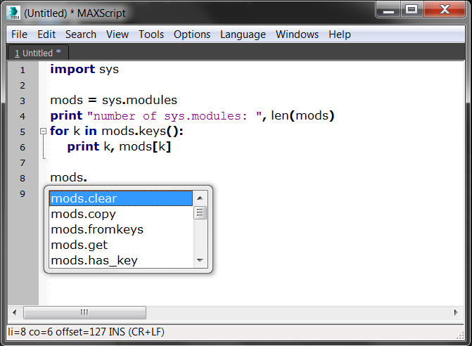

You can write and execute Python scripts in the MAXScript Editor, and run Python commands in the Max Listener window.
The MAXScript Editor supports Python language syntax highlighting and code completion for imported libraries. By default, the MAXScript Editor is set to MAXScript syntax when it first opens. Select Language > Python to change this to Python.
Code completion is invoked when you type a symbol and dot, or can be force-invoked by pressing Ctrl+Space.
Python scripts can be evaluated from the Editor using Tools > Evaluate All (Ctrl+E), and a single line can be executed using Tools > Evaluate Line / Selection (Shift+Enter). Note, to execute multi-line code blocks, select the block before executing this command.
