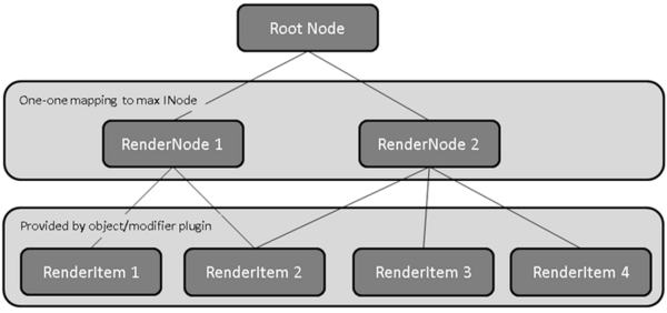

Many render nodes can refer to a RenderItem
simultaneously. The following figure shows a Nitrous scene graph example:
In Nitrous, the RenderNode
has one-one mapping to max INode
, while the object/modifier plug-in generates RenderItem
s under the RenderNode

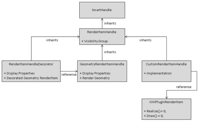

RenderItem
Types
All RenderItem
s are exposed in the Nitrous SDK as SmartHandle
s. The base class of all RenderItem
s is RenderItemHandle
. The following diagram shows the relationship between the RenderItemHandle
classes:

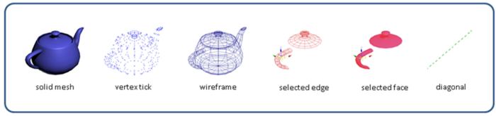

Mesh Elements
Elements in Mesh
and MNMesh
include the following:
- Solid mesh
- Selected face
- Vertex ticks
- Wireframe
- Selected edge
- Diagonal
- Selected Diagonal
- Wireframe with soft selection color
- Backface culled wireframe
The typical elements of a Mesh
and MNMesh
are show in the following figure:
The Nitrous SDK allows plug-ins to get the specified element easily. Each element is represented as a render item.

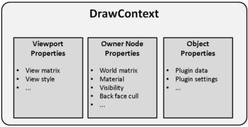

DrawContext
When implementing the ICustomRenderItem::Realize()
or ICustomRenderItem::Display()
function, plug-ins might follow the draw context. The following figure shows what a draw context is:

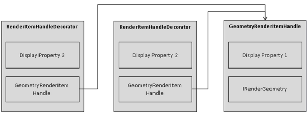

RenderItemHandleDecorator
At times if you are not satisfied with the render item generated by the mesh or other objects, the RenderItemHandleDecorator
can help replace the display properties (matrix, material) of another GeometryRenderItemHandle
without modifying the original render item. This is especially useful when you want to customize the display of an object that the plug-in references, but you do not have the source code of the object.
The following figure shows how RenderItemHandleDecorator
works:
Following is an example that shows the use of RenderItemHandleDecorator
. A BoolObject
might refer to two sub-objects and it wants to display both the sub-objects correctly.
