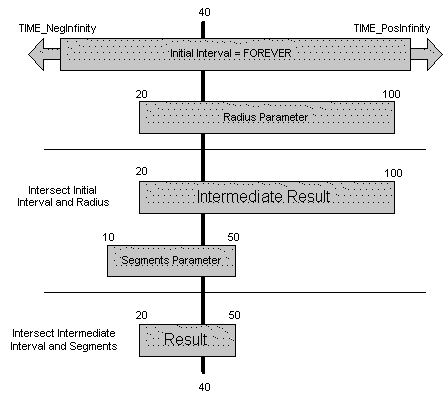

Example
Consider the example shown in the diagram below. A validity interval is computed at time 40 for an object with two animated parameters, Radius, and Segments. The interval is computed by first intersecting an initial interval of FOREVER with the Radius parameter. The Radius interval is from 20 to 100. The result of this intersection is the interval from 20 to 100. This interval is intersected with the Segment parameter interval (from 10 to 50). The result of this intersection is an interval from 20 to 50. Thus the validity interval of the object at time 40 is from 20 to 50.
