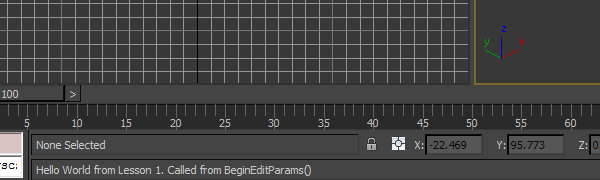

// We add this for Lesson 1:
ip->PushPrompt(_M("Hello World from Lesson 1. Called from BeginEditParams()"));
Adding the last line has resulted the following message to appear in the 3ds Max window when the UtilitySample plug-in is selected from the utility plug-in list:
However, this message will stay in the prompt area even if another plug-in is selected. We will need to pop this message from the prompt stack when the plug-in is not active anymore. We edit the function UtilObj::EndEditParam()
for this purpose. This function is called by 3ds Max when the plug-in is de-activating. This function is implemented as following in the included project Lesson1a:
void UtilitySample::EndEditParams(Interface* ip,IUtil*)
this->iu = nullptr;
ip->DeleteRollupPage(*widget);
ip->PopPrompt();
Adding the last line will remove the last message in the prompt area and restore it to its previous message.
