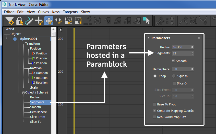

The following image demonstrates how parameters can be accessed from multiple locations such as the track-view and the roll-out:
One of the main purposes of parameter blocks is to manage the complexity of maintaining different animation controllers for different parameters. To access the values in the parameter block, the plug-in developer uses GetValue() and SetValue() methods, each take a TimeValue as a parameter. If the value hasn't yet been animated, that is, SetValue() hasn't been called with time not equal to 0, then a constant value is stored. When SetValue() is called with time not equal to 0, and animation starts, a new instance of the default controller for the parameter type is plugged in to the parameter block and initialized with the parameter's values. The parameter block also handles displaying animated parameters in the track view.
