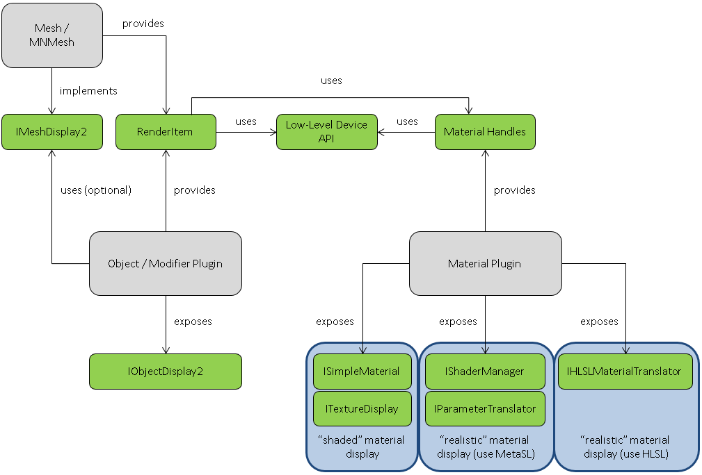

The Plugin Display SDK (previously called the Nitrous SDK) can be used by object/modifier plugins and material plugins to customize the way they display in the Nitrous viewport. The following diagram is a high-level overview of the classes and interfaces in this SDK.
