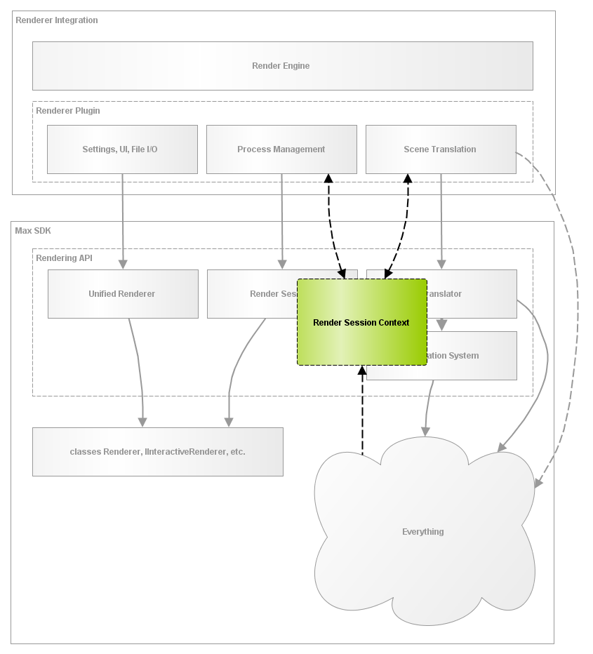

The Render Session Context is the interface through which the Unified Renderer and the Render Session communicate. It is the glue that binds the various components of the Rendering API.
The Render Session Context is created by the Unified Renderer. It is a two-way communication channel between the Rendering API core (the system) and the render session (the plugin). It encapsulates the following:
  • The scene definition, abstracted into a common, simplified representation - regardless of the render target type (offline or interactive).
  • Logging, progress reporting, and process control.
  • Frame buffer management.
  • Instancing management.
  • Notification management.
  • Etc.
