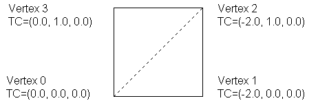

The next example shows how negative texture coordinates are used to reverse the way the image is mapped to the geometry. In the figure below, the X texture coordinates are -2.0 for vertex 1 and vertex 2. This results in the image be mirrored about the vertical axis of the map. It is also repeated twice since the coordinates are -2.0 and not -1.0.
Figure 3:
Rendering 3:

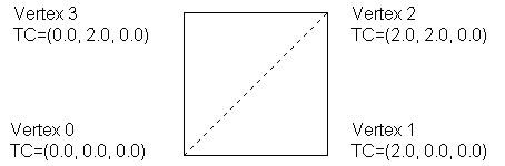

There is something special about UVW coordinates in the range of 0.0 to 1.0. If image tiling is turned off in the Materials Editor (the 'Tile' check box is unchecked for a certain direction), then the image will only appear where the texture coordinates are in this range. UV values outside the range 0.0 to 1.0 will not be mapped when tiling is off in that direction. This is shown in the diagram below. The material editor settings have tiling off in both the U and V directions, and the mapping coordinates are from [0.0 to 2.0]. Note that the image only appears where the mapping coordinates are in the range [0.0 to 1.0], i.e. the lower left corner.
Figure 5:
Rendering 5:
