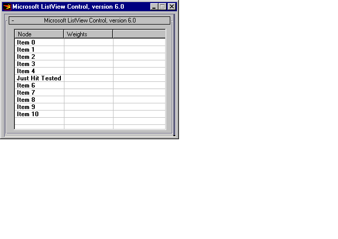

The following example will not work on your system unless it has a ListView ActiveX control installed.
SAMPLE SCRIPT
   rollout controlR92 "Microsoft ListView Control, version 6.0"
   activeXControl ax "{BDD1F04B-858B-11D1-B16A-00C0F0283628}" height:200 width:300 align:#left
   --on ax Click do format "handler: Click\n"
   --on ax DblClick do format "handler: DblClick\n"
   on controlR92 open do
   showProperties ax
   ax.MousePointer = #ccArrow
   ax.GridLines = true
   ax.AllowColumnReorder = true
   ax.BorderStyle = #ccFixedSingle
   ax.view = #lvwReport
   chs = ax.columnHeaders
   --showProperties chs
   --showMethods chs
   hTargets = chs.Add()
   hWeights = chs.Add()
   hTargets.text = "Node"
   hWeights.text = "Weights"
   lis = ax.listItems
   for i=0 to 10 do
   local li
   li = lis.Add()
   li.text = "Item " + i as string
   for li in ax.listItems do li.bold = true
   li = ax.HitTest 100 1500
   if li != undefined do
   showProperties li
   li.text = "Just Hit Tested"
   showEvents controlR92.ax
   showMethods controlR92.ax
   nr92 = newRolloutFloater "Microsoft ListView Control, version 6.0" 350 300 10 10
   addRollout ControlR92 nr92
