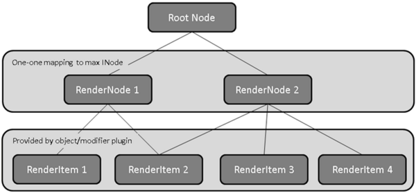

About RenderItem
The basic element that Nitrous uses to display anything on the screen is RenderItem. The object plug-in must generate a list of RenderItems according to the scene and viewport context. The object plug-ins usually do not need to hold references to these RenderItems. Nitrous internally organizes the RenderItems and manages their lifetime.
Many render nodes can refer to a RenderItem simultaneously. The following figure shows a Nitrous scene graph example:
In Nitrous, the RenderNode has one-one mapping to max INode, while the object/modifier plug-in generates RenderItems under the RenderNode.

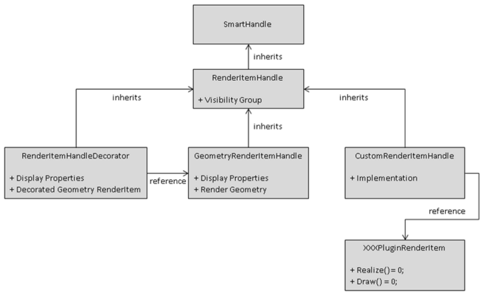

RenderItem Types
All RenderItems are exposed in the Nitrous SDK as SmartHandles. The base class of all RenderItems is RenderItemHandle. The following diagram shows the relationship between the RenderItemHandle classes:

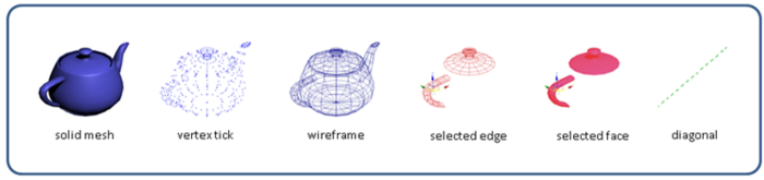

Mesh Elements
Elements in Mesh and MNMesh include the following:
  • Solid mesh
  • Selected face
  • Vertex ticks
  • Wireframe
  • Selected edge
  • Diagonal
  • Selected Diagonal
  • Wireframe with soft selection color
  • Backface culled wireframe
The typical elements of a Mesh and MNMesh are show in the following figure:
The Nitrous SDK allows plug-ins to get the specified element easily. Each element is represented as a render item.

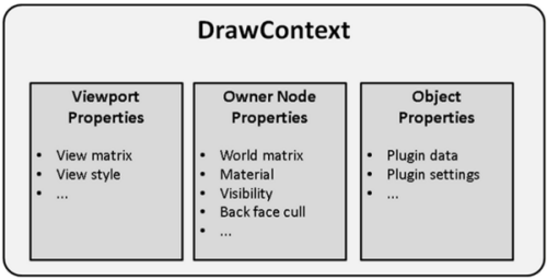

DrawContext
When implementing the ICustomRenderItem::Realize() orICustomRenderItem::Display() function, plug-ins might follow the draw context. The following figure shows what a draw context is:

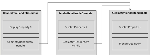

RenderItemHandleDecorator
At times if you are not satisfied with the render item generated by the mesh or other objects, the RenderItemHandleDecorator can help replace the display properties (matrix, material) of another GeometryRenderItemHandle without modifying the original render item. This is especially useful when you want to customize the display of an object that the plug-in references, but you do not have the source code of the object.
The following figure shows how RenderItemHandleDecorator works:
Following is an example that shows the use of RenderItemHandleDecorator. A BoolObject might refer to two sub-objects and it wants to display both the sub-objects correctly.
