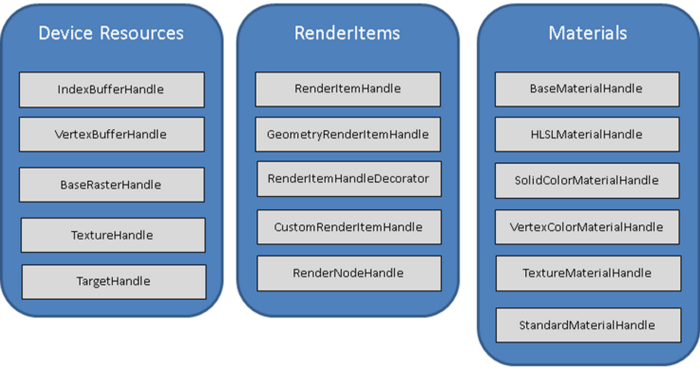

The Nitrous SDK provides a list of strong typed handles. These handles are derived from SmartHandle and they have no data members, but several methods for plug-ins to manipulate the underlying resources.
The following figure shows the smarthandle types in the Nitrous SDK:
