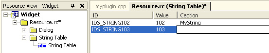

- The string table resource editor will look like the following:
