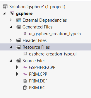

Save the form as gsphere_creation_type.ui in the project folder, and then add it to the Resource Files in the Solution Explorer in Visual Studio. Because this is a Qt Add-in project, Visual Studio recognizes the UI file and creates an associated header for it:
Note: this header file does not yet exist, because the .ui file has not been compiled. You can force it to compile by right-clicking on the associated .ui file and selecting Compile.

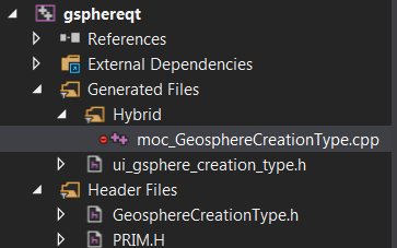

Visual Studio should recognize that our new wrapper class is a Q_OBJECT and to generate Qt moc files for it. Check that a moc file is now auto-generated:
Once the files are configured correctly, you can right-click .ui files and select "compile" in Visual Studio to actually generate the layouts header moc files based on your design.
Right-click the gsphere_creation_type.ui file, and select Compile. You should now be able to open and verify that ui_gsphere_creation_type.h is generated.

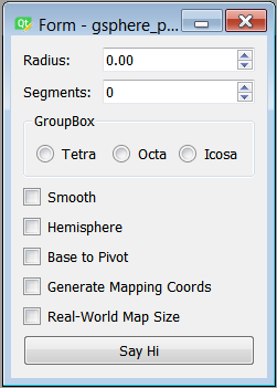

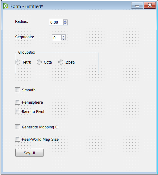

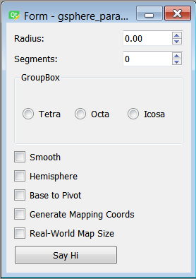

Create a new widget, add a Double Spin Box, a regular Spin Box, three radio buttons in a group box, and five check boxes. Let's add a button to illustrate how to hook up slots, even though there isn't one on the original roll-out. Remember to add a ButtonGroup named "baseType" (to associate it with the baseType parameter), and add all the radio buttons to it. Finally, add labels for the spin boxes, and lay them out approximately like they appear on the rollout we're trying to re-create:
Select the group box, and apply a grid layout. Apply a grid layout to the whole widget, and then select Adjust Size. The final layout should look like this:
Optional: You can tweak the layout a bit in Qt Designer to get slightly better results. In our example, the spin boxes look a bit narrow, and appear to float over to the left side of the rollup. This is because the grid layout has placed them in the second column of the grid, and the checkboxes below cause the first column to be quite wide. To make the layout look a bit better:
  • Drag the resize handle for each checkbox over to the left, so each checbox spans both columns.
  • Drag the resize hanlde of the sayHi button over to the left, so the button spans both columns as well.
  • Select the form QWidget, and find the layoutColumnStretch property. Set this to 0,1. The result should be wider spin boxes:

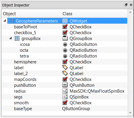

Rename the widgets to match their corresponding parameter names. Name the button "sayHi". Finally, rename the form "GeosphereParameters" to match the name of the wrapper class we will create next.
