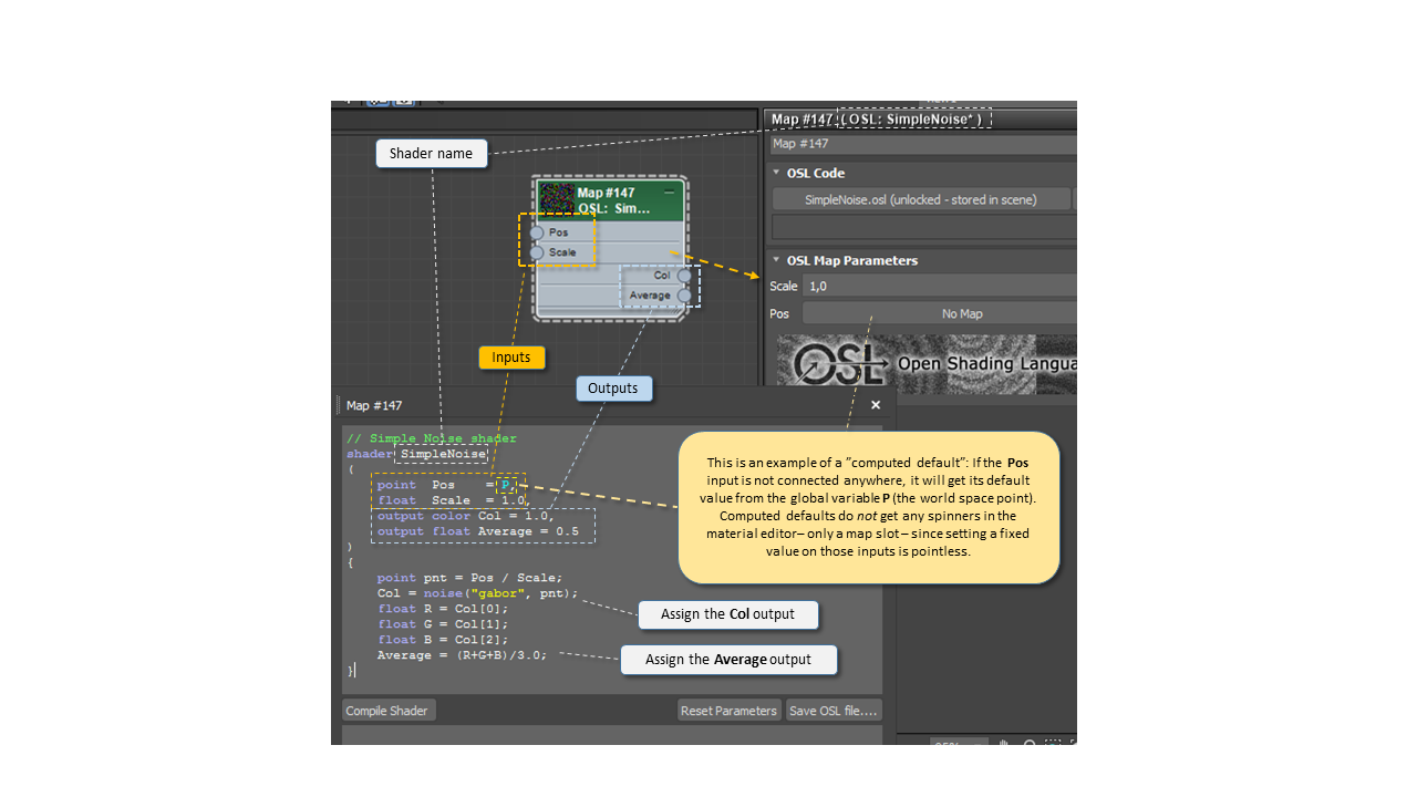

Writing an OSL shader for 3ds Max
A complete description of the latest version of OSL is available in the Open Shading Language Specification.
osl shader example
General points about OSL in 3ds Max:  
  • A shader looks very similar to a C/C++ function definition.
  • Shaders have inputs and outputs. Both inputs and outputs always have to have a default value assigned, without which an error is emitted when compiling.
  • Inputs can sometimes have computed defaults. This is the value the input gets if it is not connected to anything. Most procedural texture shaders have an input for the coordinate for which it is texturing, but also uses a computed default so that the shader does something reasonable without being forced to connect, for example a UV generating shader to its input.
  • Since computed defaults are used for parameters that are inherently varying across the texture, having "fixed value" inputs for them is meaningless. Hence, no value spinners are shown for these in the UI, but only the slot for connecting them to some other shader.

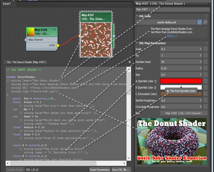

Shader Metadata
In OSL metadata can be assigned to whole shaders, or individual parameters. 3ds Max supports a subset of those metadata settings, as well as some of its own.
For the shader, the following metadata are supported
Name Meaning
label The "display name" of the shader. This is what is displayed the Material Browser, as well as the title in the Material Editor and on the node in Slate Material Editor.
help A short help text displayed the top of the material editor.
This can contain a subset of HTML formatting.
URL A link to a more extensive help page about the shader.
logo An image loaded from the same folder as the OSL shader, and displayed at the bottom of the material editor in place of the default logo. This Allows you to personalize the look of your shaders, or even include a sample image of what it does directly in the UI. If the file cannot be found, the default logo is displayed.
category Sorts this shader in a particular category in the 3d Max Map browser.
By default, categories are determined by the subdirectory the shader is in, but this can be overridden by a specific category metadata value. It allows nested categories separated by a backslash, for example "Math\Color" puts the in the "Math" category, with a sub-category of "Color".
version The version number of the shader. It should be a string of up to three dotted numbers (e.g. "1.3.11") to encode the version of the shader, although a float or integer version number also works. A shader with no version metadata is considered as version zero.
For individual parameters, the following metadata are supported:
NameDescription
labelThe "display name" of the parameter. The parameter name displayed in the Material Editor.
helpThe tooltip of the control. This can contain a subset of HTML formatting.
min, maxThe minimum and maximum value of the parameter.
stepThe step size for spinners.
connectableIf 1 (the default), the parameter will have a corresponding map input. If 0, there will be no map input. I.e. the parameter can not be connected to, only set by the widget.
widgetThe kind of UI control to use for the parameter. Supports the following OSL widget types:
  • "filename" - displays a file selector button beside the text field, and makes the pointed-to file a 3ds Max "asset" editable via the asset tracker. A shader using this also automatically pops up a file dialog when the it is instanced, unless the autopop metadata is 0.
  • "checkBox" - displays an integer value as a checkbox.
  • "popup" - displays a popup list of choices.
  • "mapper" - displays a popup list of choices that maps to other values such as integers
  • "null" - displays no widget at all. There is still a map input (unless connectable is 0).
  • "max:xxx" - additional 3ds Max specific widgets. See the user interface section.
See the OSL Specification for details
timeValueIf enabled (set to 1), any integer parameter this metadata is assigned to automatically gets populated with the current frame number, and any float parameter gets automatically populated with the current scene time, in seconds.
worldunitsIf enabled (set to 1), any float parameter this metadata is assigned to will be displayed using display units, seen by the shader in system units, and the default value will always be in meters.
autopopIf the parameter has a widget of type "filename", a file browser will automatically pop up when creating the shader, similar to how the classic Bitmap behaves. If this is not desired, you can set autpop to 0 and disable the behavior. The default is 1.
packNameAllows grouping parameters on the same row. Any parameters with the same packName will show up on the same row in the UI, headed by that name. The regular parameter labels are ignored.
widgetWidthAdjusts the width of the widget (measured in pixels at 100% UI scaling).
Metadata Example
Here is a visual example of how metadata shows up in an OSL shader:
metadata example

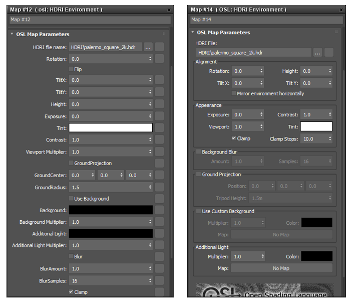

Advanced User Interface (3ds Max 2021-)
Several improvements have been made to the UI engine for OSL, adding some components that are not strictly standard. However, care has been taken so these additions are only extensions. Meaning, the shader itself will work "as is" in any standard compliant OSL host - or an earlier 3ds Max version - it's just that the UI will be less "fancy" than what it is starting from 3ds Max 2021.
Metadata-driven UI
Additional metadata can be used to make more complex UIs.
  • The widget type "null" will make the parameter invisible (although it is still acessible through maxscript, and controllers can be assigned to it).
  • The metadata connectable, when set to 0, will remove the map input for the parameter. The parameter itself still exists, but it can't be connected to by another shader. This reduces clutter and makes the node smaller in SME, and can be used for parameters where it's unlikly it will ever be useful to connect it to another shader (like a mode switch).
  • The metadata worldunits, when set to 1, will make the parameter type a TYPE_WORLD, which means it will be displayed in the currently selected display unit, its value (as seen by the shader) will always be in scene units, and the default value will always be given in meters.

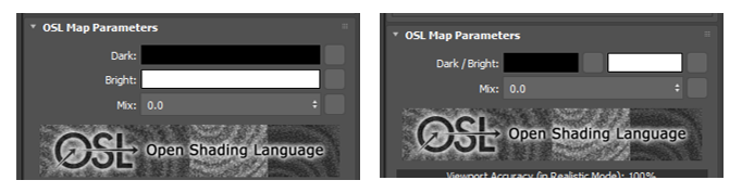

Row Packing
By default, one parameter per row is displayed. This tends to make the UI very "tall" with a lot of scrolling around for shaders with lots of parameters. But sometimes parameters are related to each other (e.g. a multiplier and a color) which makes it desirable to be able to put multiple controls on the same row.
To facilitate this, use the metadata packName. It decides which parmeters to "pack" into the same row. Any two or more parameters that have the same "packName" will show up on the same row, with that "packName" as the row header. To additionally size the columns as needed, the metadata widgetWidth allows some amount of adjustment of the relative size of the widgets, to keep the layout looking balanced.
In the below example, on the left, the Dark and Bright parameters are on separate rows. But on the right, both of them have been given the packName of "Dark / Bright", putting both on the same row, with that heading:
example of packing two parameters on one line

HDRI Environment shader with no custom UI (left) and the custom UI (right):
automatic vs custom ui
If there is no .ui file, or if the shader was loaded into an earlier version of 3ds Max (or even another software entirely) it would look like on the left. But by supplying the file HDRIEnviron.ui in the same folder as HDRIEnviron.osl, we get the result on the right.
