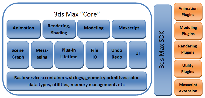

The following diagram provides a representation of the interaction between 3ds Max core, the 3ds Max SDK, and plug-ins.
The plug-ins expose their functionality by providing concrete implementations of a set of abstract classes from the 3ds Max SDK. Plug-ins also interact with the 3ds Max core by calling concrete classes, or abstract classes (interfaces) implemented by 3ds Max.
