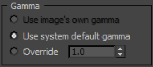

The dialog for loading bitmaps had three options:

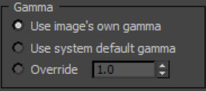

Similarly, the dialog for saving bitmaps had two options:

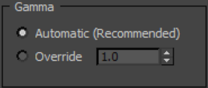

Currently, both saving and loading dialog has the same options as shown in the following figure:
The gamma value in the file header is used when you choose the Automatic option for loading files. When file headers do not contain the gamma value, the file type is considered and 3ds Max checks whether the particular file IO plug-in prefers linear storage or not. For example, the plug-in for JPG files do not prefer linear storage, and is assumed to be sRGB (= gamma 2.2). The plug-in for HDR files prefer linear storage and is assumed to be linear (= gamma 1.0).
Similarly, when saving files, the file type is considered and 3ds Max checks whether the file IO plug-in prefers to be saved linearly. For example, a JPG plug-in is saved in sRGB (= gamma 2.2) by default, whereas an HDR plug-in is saved linearly (= gamma 1.0) by default.
You can override this default behavior using the Override option for loading and saving the files.
