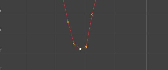

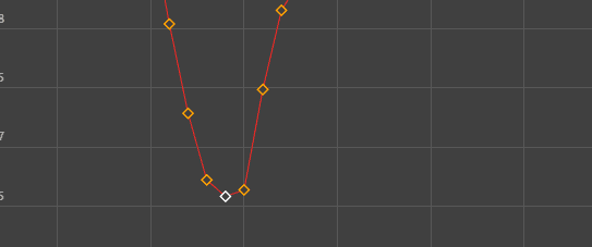

- Auto-adjust key size on zoom
Auto-adjust key size on zoom on
- Turn on this option so that Graph Editor keys resize to stay in scale with the curve when zooming in the Graph Editor Graph view. If unchecked, keys stay the same size regardless of how far you zoom out.
Auto-adjust key size on zoom off
- Key Size
Lets you control the size of the keys shown in the Graph Editor Graph View. Key size is percentage of the original key size (100% or a value of 1). You can scale keys between 40% (0.4) and 200% (2).
Tip: Use the following command to exceed the default size settings: animCurveEditor -edit -keyScale 0.8 graphEditor1GraphEd;

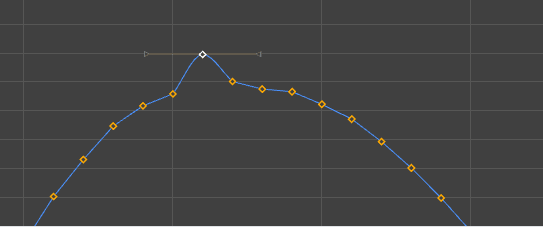

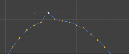

- Tangent handle size
Adjusting the Tangent handle size
- Enter a value or use the slider to make the Tangent handle larger or smaller.
- Tangent Line thickness
Adjusting the Tangent arm size
- Enter a value or use the slider to make the Tangent arm thicker or thinner.
- Min key selection size
- Lets you set the selection area boundary for selecting keys. Changing this setting is useful if you are unintentionally including keys when drag-selecting in the Graph View. It's a good idea to decrease the boundary size with this setting when working with scenes with dense animation and the Graph Editor is at reduced size so the keys selected are more precise.
