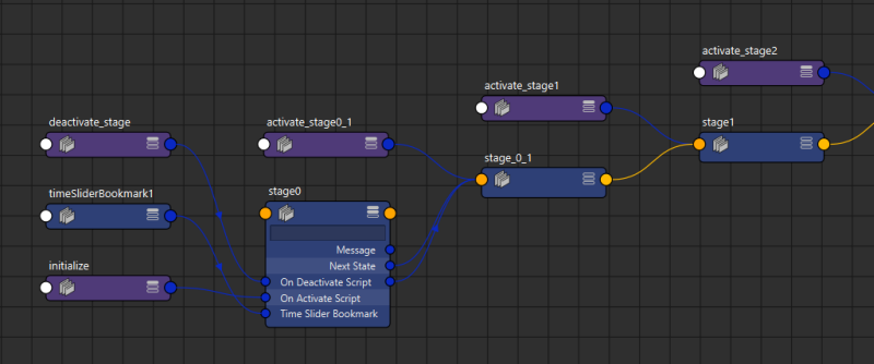

To view the state machine
- In the Outliner, turn off .
- Filter by the term "stage".
- Select all the stage nodes.
Note: There will also be a number of "activate_stage" nodes alongside the stage nodes. You do not need to worry about these yet.
- Open .
- Click the
Show Inputs / Outputs button (
) to display the stage nodes and their connections.
- On Activate Script: This is the script node where the bulk of each stage happens. You can view the Python code in the Expression Editor (see below).
- On Deactivate Script: Connect a script node here to clean up after a stage once it's finished. It's good practice to try and keep your stage logic self-contained so that it's easy to move them around or insert/delete them as needed. In the example above, it's clear that a stage0_1 was inserted between stage0 and stage1 at some point during development. It can also be handy to design a universal deactivate script that can be used by all stage nodes, allowing you to simply connect all the On Deactivate Script attributes down the chain for readability.
- Time Slider Bookmark: This is handy for setting up animations at the beginning of a stage, but also for changing the state of a scene between one stage to another. For example, you can keyframe the active camera at the start of the bookmark to have the camera jump to a different spot in the scene at the beginning of the stage. Or you can keyframe an object's visibility to have it appear during one stage but not another.
