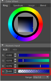

For items marked Index, you can change the item color by adjusting the corresponding color slider or selecting a color from the Index Palette at the top of the Active or Inactive section. You can only choose from the available Index Palette colors.
For items that are not marked Index, you can change the item color by adjusting the corresponding color slider or by clicking on the colored box and selecting a color from the Color Chooser.

See Set wireframe transparency for more information.
