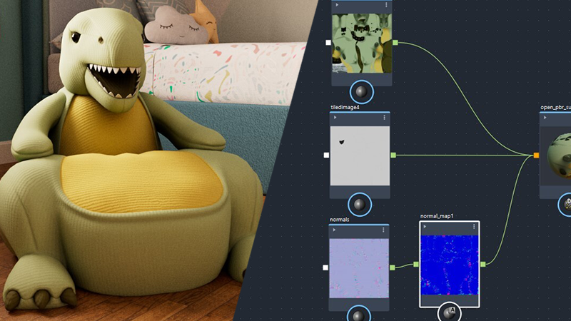

Node Previews
MaterialX nodes in LookdevX graphs now have swatches that allow you to instantly see the result of any node or combination of nodes without needing to render the entire scene. As node properties are tweaked, node previews update in real time, providing live visual feedback without the need to recompile shaders or re-render. Node previews in a material graph editor enhance the usability, speed, and accuracy of shader/material development. They turn abstract data into visual cues, empowering you to make faster and more confident creative decisions.
