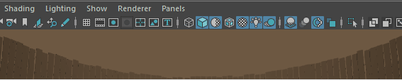

In-view Messages
You can show, hide, or change the display of the in-vew messages that appear for certain tools, modes, and operations.
In-View Message example
Enable
Shows or hides all in-view messages. The default is on.
Note: You can also show or hide In-View Messages in the Heads Up Display options.
User assistance messages
Shows or hides messages that explain how to perform operations. The default is on.
Status information messages
Shows or hides messages that provide information about a change in Maya's status. The default is on.
Display time
Sets how long the tool message appears on screen, in seconds. The default is 2 seconds.
Font size
Sets the text size of the in-view message, in points. The default is 12 points.
Background opacity
Sets the opacity of the in-view message background, as a percentage. The default is 75, with 0 being fully transparent and 100 being fully opaque.
