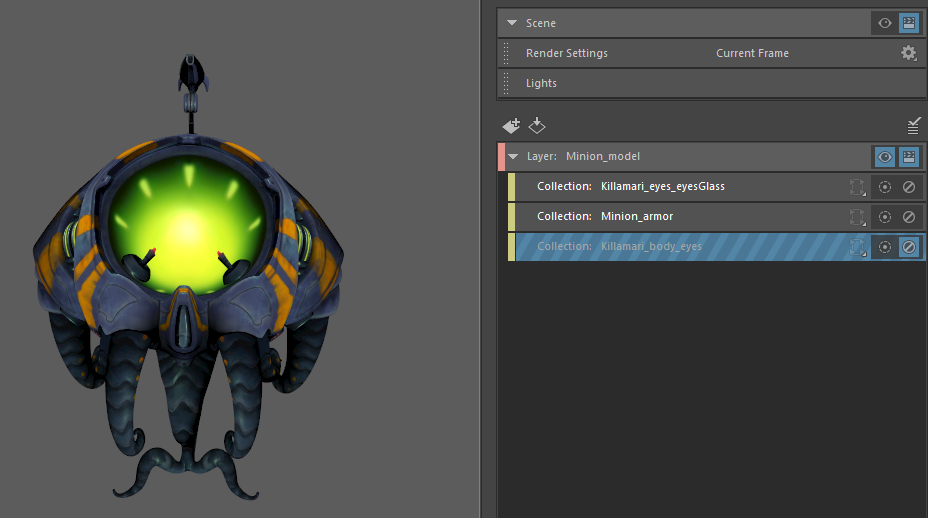

Enable/disable conditions are interpreted top-down. Therefore, if two (or more) of your collections share objects, and one of your collections is enabled and the other is disabled, it is the collection furthest down on the list that determines whether the shared object is included in the layer.
In this example, the collection Killamari_body_eyes includes the body and eyes of the character.
Meanwhile, the collection Killamari_eyes_eyesGlass includes the eyes and eyes glass of the character.
Because Killamari_eyes_eyesGlass is further down in the hierarchy than Killamari_body_eyes, and Killamari_eyes_eyesGlass is set as enabled; therefore, the character's eyes are included in the layer.

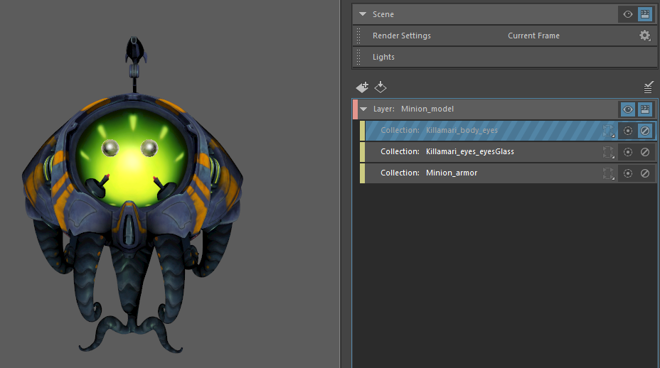

Now if you reverse the order of the two collections: if Killamari_body_eyes is further down in the hierarchy than Killamari_eyes_eyesGlass, and Killamari_body_eyes is set as disabled, then the Killamari_body_eyes collection takes precedence and the character's eyes are excluded from the layer.
