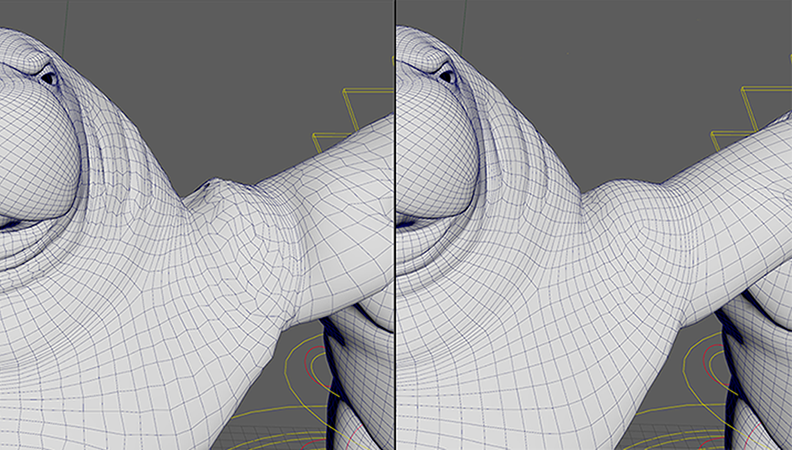

  • Improved shape training: When training the deformer, a new Tune Principal shapes during training mode is available, which parameterizes principal shapes so they can be adjusted during training. This can improve results, especially when all the training poses don't fit in the SVD analysis.
  • Learn Surface: A new Learn Surface option has been added to the training window, which can improve noisy results.

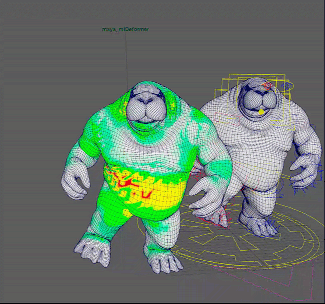

Mesh compare
You can now use Apply Mesh Compare to visualize the difference between two meshes using a heat map. This is especially useful when combined with the ML Deformer, since it can either show where deviations exist between the source and target mesh, or areas where the deformer is performing the most work.
