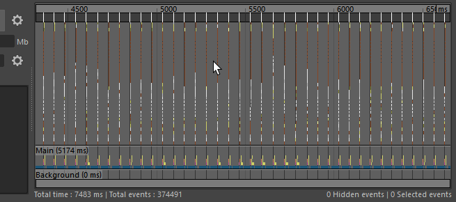

The Profiler lets you locate performance bottlenecks in your scene by recording and demonstrating in a graph the amount of time that each process consumes.
You can determine when to start and stop recording. You can also save your recording as a text file and reload it in the draw region at a later date. You can perform these tasks via the Profiler window or via the profiler MEL/Python command.
Graph your events in one of the following ways:
  • Category view: displays the activities for different categories. This is the default view.
  • CPU view: displays the activities of each of your processors. Select this view to better evaluate multi-threading.
    Note: CPU view is unavailable on Mac OSX.
  • Thread view: displays the activities of each of your threads. Select this view to evaluate all the activity on a single thread.
For more information on how to record a process and how to work with and interpret your graph, see Profile a scene to improve performance .
You can also instrument procedures in your plug-in for profiling. Instrumentation is the modification of a program to collect information for analysis. Use the profiler -instrumentMel flag to instrument a MEL procedure. Use the MProfiler::MProfilingScope() method to instrument a method in your plug-in. For more information, see Work with the Profiler using MEL/Python and the API.
