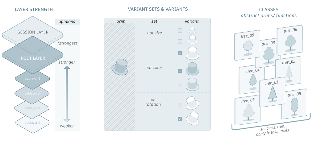

USD is designed for collaboration
The power of USD lies in its layering system, which facilitates collaboration between different artists and studios via non-destructive editing. For example, if you start with an existing scene and create a new layer containing your edits, these edits won't affect anyone else using the same scene unless they decide to include your new layer. Together, multiple layers provide a complete view of the scene, which is known as the stage.
A basic understanding of USD will make it much easier to use and understand Maya's implementation of the USD framework. While the Maya documentation does not include a USD glossary or a complete overview of USD concepts, the following sections provide an overview workflows to showcase what you can do with USD in Maya and where to go to learn more.
For a better understanding of USD concepts, you can watch USD tutorial videos and content on the Maya Learning Channel. View the USD series for real-time explanations of concepts and theory alongside practical workflow showcases.

Related Concepts: See variant, variantSet, instancing, metadata in the Pixar USD Glossary.
