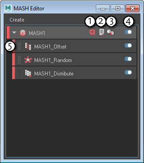

The MASH Editor can be used to view, select and modify MASH networks in your scene. You can access it via MASH > MASH Editor in the Animation or FX menu sets, or via the MASH shelf.
For a list of functions, see the table below this image.
1 - Add node
Click this button to display a drop down list of nodes. Select one to add it to the MASH network at the top level. For more information on specific nodes, see MASH Nodes overview.
2 - Add utility
Click this button to display a drop down list of utilities. These utilities include:
3 - Select repro / instancer
Selects the Repro or Instancer node depending on the MASH network's current geometry type.
4 - Toggle node
Disables / enables the corresponding MASH node. Clicking the top-level button affects the Distribute node.
5 - Move node
Drag nodes with a dotted white handle to reorder them in the stack. Nodes only affect whatever is below them, so reordering them can change the effect of a node on a MASH network.
Nodes with a dark solid handle cannot be reordered.
