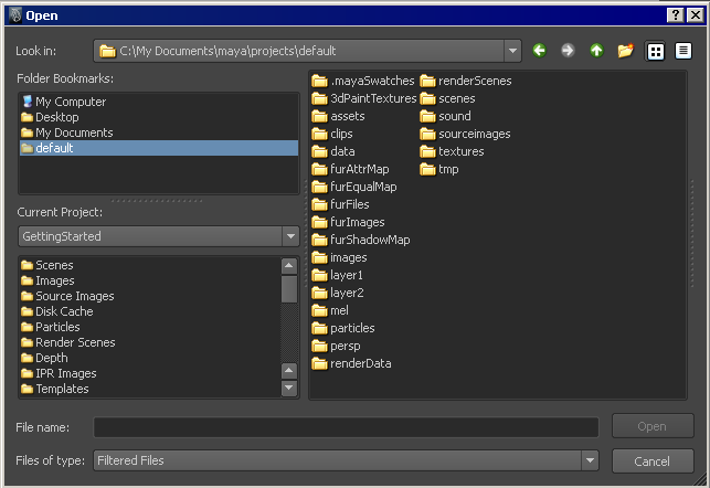

Letting the user choose a file with fileDialog
The fileDialog command shows a file open dialog window. See fileDialog in the Maya Mel Commands documentation
- Use the
directoryMask flag to specify the starting directory and a filename filter. If you don’t use this flag, the file dialog starts in the current working directory.
The string may contain a path name, and must contain a wildcard file specifier. (for example "*.cc" or "/usr/u/*").
- The command returns the path of the file the user chose, or an empty string if the user cancels the file dialog.
fileDialog -directoryMask "*.txt"
