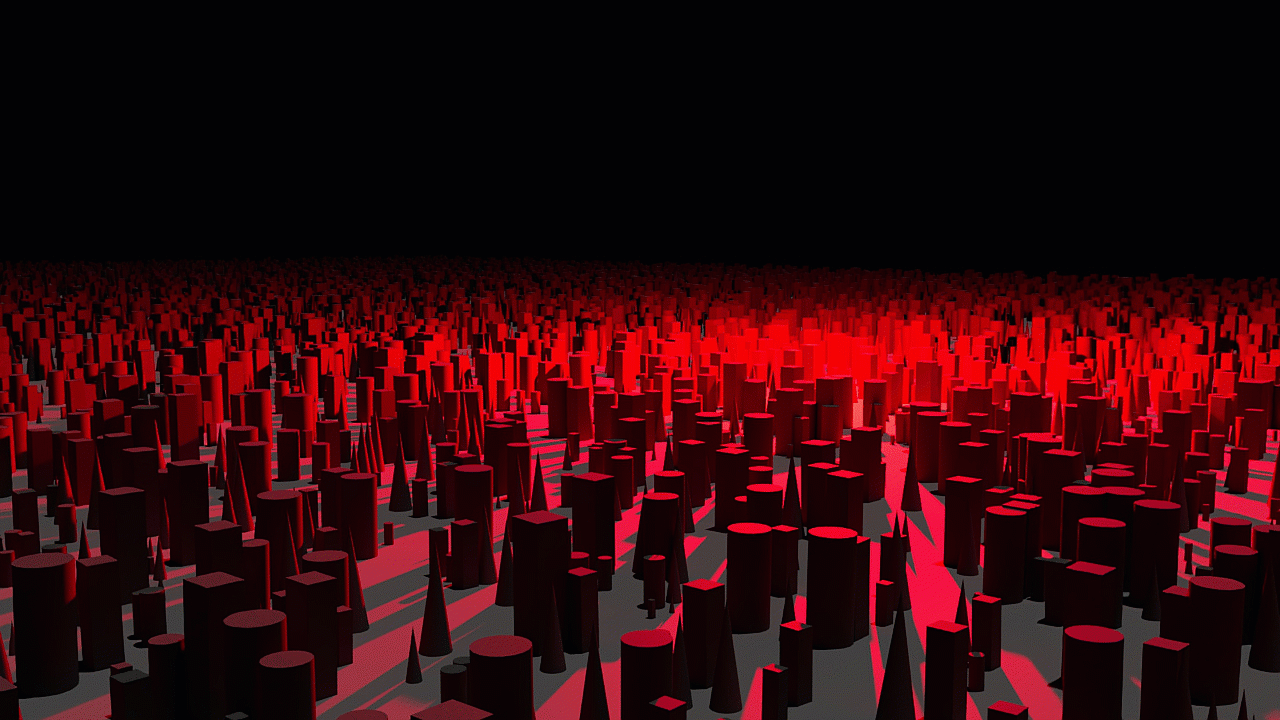

Lighting in USD
  • Light linking support. USD for Maya 0.31 now supports light linking, giving you more control over the relationships between lights and objects in your scene.
    gif for
  • Look through lights. This new feature lets you control lighting by looking through a selected light source. You can easily adjust the light's position and direction using standard viewport commands.
