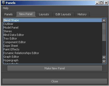

New Panel
Contains controls for creating a new panel type.

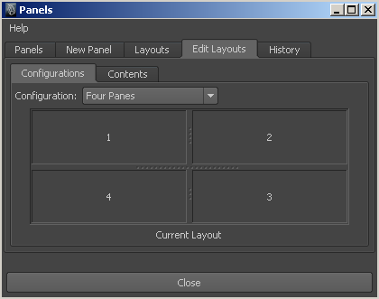

Create a custom panel layout
- Configurations
Use this tab to change the configuration and proportions of the layout.
From the drop-down list, select the panel layout you want.
Resize the panes by dragging the borders in the thumbnail view of the layout. The main window changes to reflect your changes.

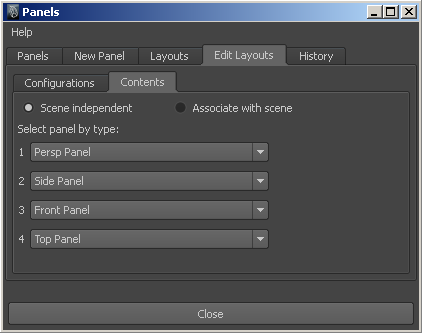

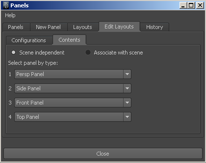

- Contents
Use this tab to change which panel contents appear in the layout.
- Scene Independent
Scene independent layouts are available for all scenes. Their contents are defined by panel types.
If you have multiple panels of the same type in a scene, it is not certain which panels show up when you select your layout. This is not a problem in most cases; however, if you are working a lot in a particular scene, you may want to develop layouts to save specifically with that scene.
- Associated with Scene
These layouts are only usable with the current scene. You can specify a particular panel if you have more than one of the same type.
