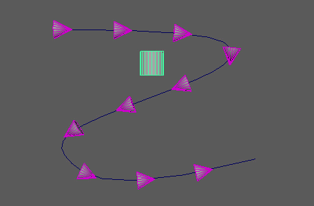

- Determines method of orientation. Options include:

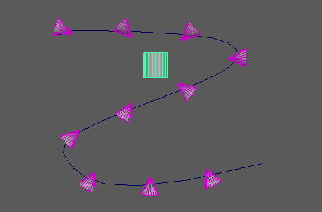

- Velocity: Orients objects along their direction of travel.
- Aim at Target: Points objects toward a specified object in the scene.

- Up Vector
- Defines which direction is up for your objects. For the best results, point your input objects down the X axis.

Aim at Target Options
- Target
- Displays the object that the objects will aim at when Orient Modeis set to Aim at Target. You can assign the currently selected object either by middle-dragging it to this field or by right-clicking the field and clicking Connect.
