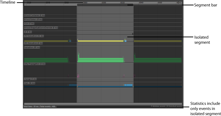

To isolate and inspect a particular segment
Click the segment that you want to isolate on the segment bar. The isolated segment is now highlighted while the rest of the graph appears dark. When a segment is isolated, only the events in the segment are accounted for in the statistical information at the bottom of the Profiler (such as the total number of events).
- To frame all events in this segment, press A.
- To isolate a different segment, click on the next segment that you want to isolate.
- To return to the default view; that is, to un-isolate the segment, click on the segment again on the segment bar. Press A again to zoom out and frame all events in your recording.
- To query the number of segments, run the following command:
profilerTool -q -segmentCount;
You can also isolate a specific segment or return to the default view using commands. See the profilerTool command documentation for more information.

Statistical information in the Profiler
In addition to the statistical information provided for each event (for example, its duration and thread ID, the bottom of the Profiler also lists the following information:
- Total time recorded
- Total events recorded
- Number of hidden events
- Number of selected events
Hidden events are not included in the Total time and Total events count. If a segment is isolated, only the events in the isolated segment are included in these statistics. Isolated events are not considered hidden.
