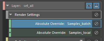

Lower the sampling in the Render Settings for interactive renders
The following example includes two overrides on the Render Settings sampling attribute: one with a higher number of samples for batch renders, and another with a lower number of samples for local test renders. The latter has been converted to a local render override.
Because overrides are interpreted top-down, the local render override should be placed lower than the batch render override. During interactive rendering, the Samples_local override takes precedence and a lower sampling quality is used. During batch rendering, the local render override (Samples_local) is ignored and only Samples_batch take effect, so that batch renders are performed with the higher sampling quality.

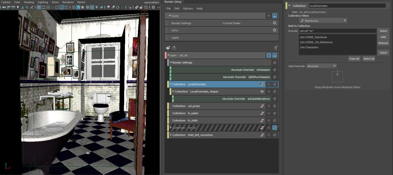

Adding a Local Override collection to a Render Setup where a collection may be disabled
Because collections are interpreted top-down, this collection should be the top-most collection in your layer so that it does not take precedence over other collections and overrides in your layer.
In this example, the character belongs in two collections: LocalOverride and chr_all.
If LocalOverride appears on top and chr_all appears below, and chr_all is disabled, then chr_all is not rendered. This is the correct behavior.

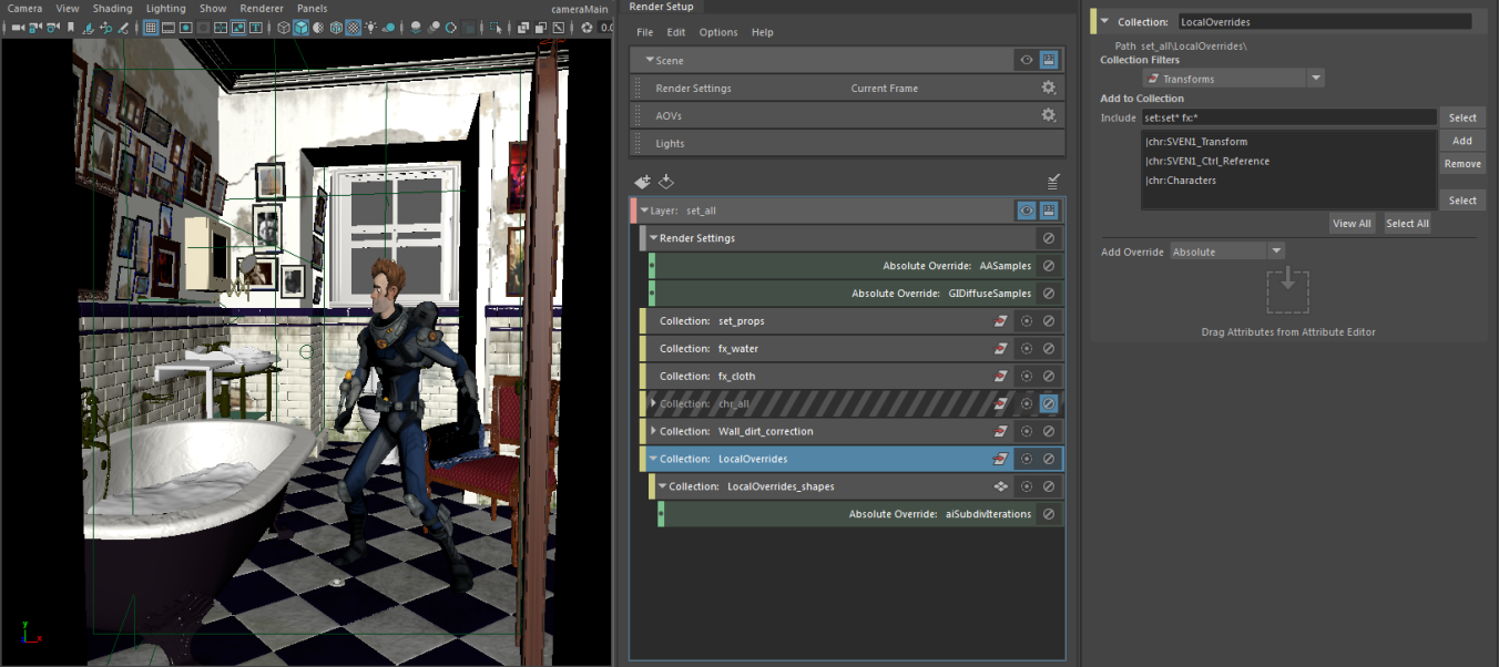

However, if chr_all appears on top and LocalOverride appears below, then your character will appear in your render, even though you have disabled the chr_all collection. This result is incorrect because the LocalOverride collection includes the character and is enabled.
