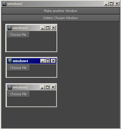

In this example, MEL makes a window that can be used to create more child windows. The $chosenOne global variable tracks which child window the user has selected. Within each newly created child window, there is a chooseMe button that the you can click to set that specific window as the $chosenOne. When you click Delete Chosen Window in the main, parent window, the $chosenOne gets deleted.
In the image below, window4 is the $chosenOne, and will be deleted when Delete Chosen Window is clicked.
The code is as follows:
global proc int pressMe(string $thisOne) {
	global string $chosenOne;
	print ("was " + $chosenOne + "\n");
	$chosenOne = $thisOne;
	print ("nowIs " + $chosenOne + "\n");
	return 1;
global proc int satWindow(){
	string $temp = `window -width 150`;
	columnLayout -adjustableColumn 1;
	button -label "Choose Me" -command ("pressMe " + $temp);
	showWindow;
	return 1;
global proc int baseWindow() {
	window -width 150;
	columnLayout -adjustableColumn true;
	button -label "Make another Window" -command "satWindow";
	button -label "Delete Chosen Window" -command "deleteUI -window $chosenOne";
	showWindow;
	return 1;
baseWindow()
