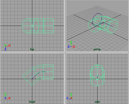

Flat maintains the orientation of the cross section as it moves along the extrusion path.

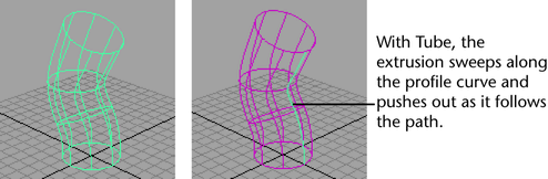

Tube sweeps the cross section along the path with the reference vector staying tangent to the path.

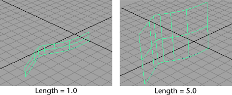

Distance extrudes the profile in a straight line. Do not select a path curve when you turn on this option. When Distance is on, the options window provides extra options: Extrude Length, Direction, and Surface Degree.
Extrude Length
Specifies how far the extrusion goes.

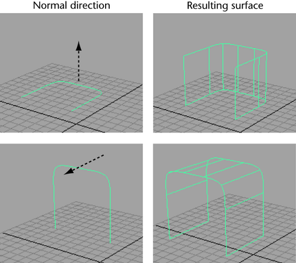

Direction
Profile Normal sets the direction of the path to the normal of the profile curve. If the profile curve is not planar, the average normal is used.

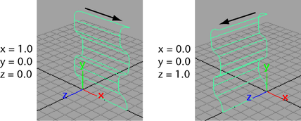

Specify lets you choose a Direction Vector for the extrusion: X Axis, Y Axis, Z Axis, or Free. For example, if you click the Z Axis button, the extrusion will be linear in the Z direction.
If you select Free, you can enter values in the X, Y, and Z boxes to specify a vector as the direction for the extrusion.

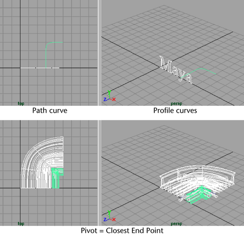

Pivot
The Pivot options are available only if you set the Style to Tube. If you select At Path as the Result Position, you can choose the profile curve then position it at the pivot point on the extrusion path.
If you select Closest End Point, the path end point closest to the center of the bounding box of the profile curves is used. This end point is used as the pivot point for all the profile curves. If you are doing a multiple extrusion, the resulting surfaces are offset from the path.

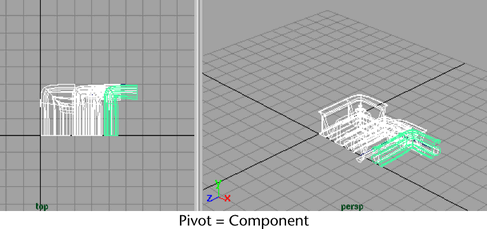

If you select Component, the pivot point of each individual profile curve is used to extrude the profile curve. The extrusion occurs along the components of the profile curve.

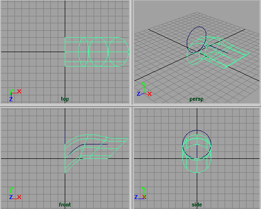

In the following example, Result Position is set to At Profile and Orientation is set to Profile Normal. The path curve is moved and rotated to match the profile curve. This is the default setting.

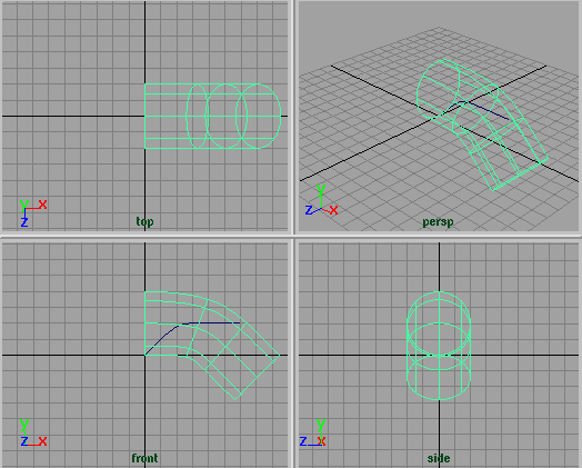

In this following example, Result Position is set to At Path and Orientation is set to Path Direction.
In the following example, Result Position is set to At Profile and Orientation is set to Profile Normal. The profile curve is moved and rotated to match the path curve.
