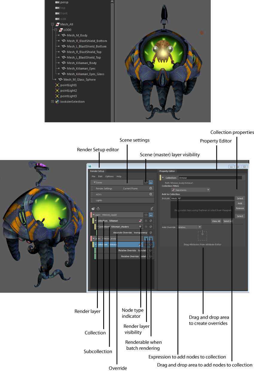

Click on the status line to open the Render Setup editor. The Render Setup workspace window appears, with the Render Setup editor on the left and the Property Editor on the right. The Render Setup editor allows you to create layers, collections and overrides, while the Property Editor allows you to set their corresponding values. In addition, the Render Setup editor allows you to access your scene settings via its Scene tab.

In this example, the first layer has a collection that contains the squid character. An override is applied on the Transparency attribute of the shaders; thus a Killamari_shaders subcollection is automatically created. The second layer has a collection that contains the armor of the Minion character, and a relative override is applied to its Rotate attribute, and another relative override is applied to its Translate attribute.
