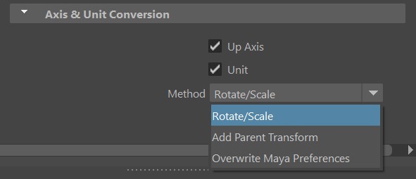

Axis & Unit Conversion
If the Up Axis/Unit box is checked, the Up Axis/Unit is automatically converted to be consistent with Maya's current scene.
- Rotate/Scale: This method applies a transformation to the top-level objects in the imported file to match the current scene's axis/unit. The original axis/unit information can be viewed in the objects' Extra Attributes in the Attribute Editor.
- Add Parent Transform: This method creates a new parent transform node for the imported objects. The parent node is transformed to align the imported data with the current scene's axis/unit. You can view the original Up Axis/Unit information in the objects' Extra Attributes in the Attribute Editor.
- Overwrite Maya Preferences: This method changes the Up Axis setting in Maya's preferences to match the axis/unit of the imported file.
