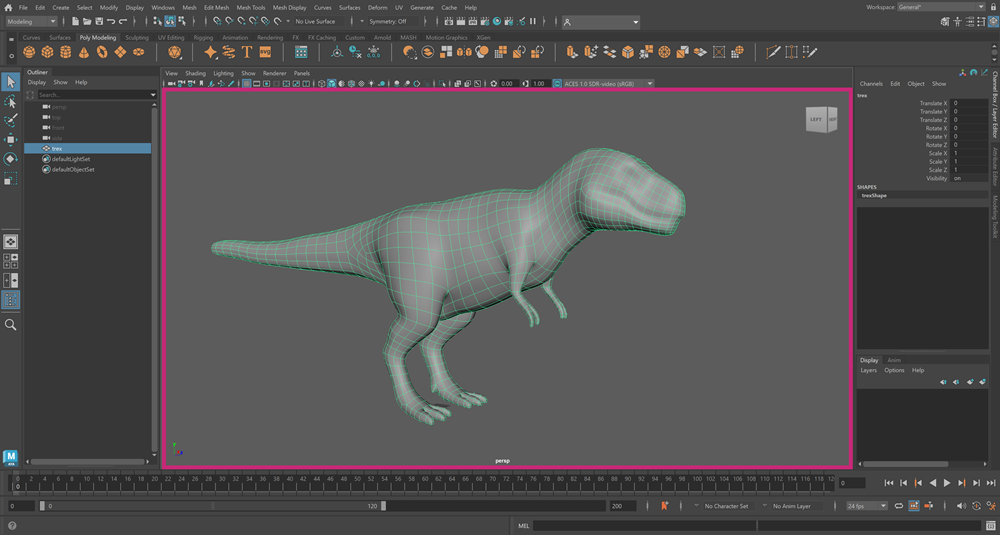

Working in Viewport 2.0
Viewport 2.0 is the viewport and hardware renderer in Maya - it's the way you view your scene.
