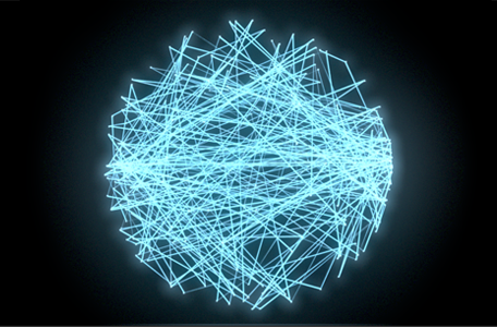

- Trails Mode
- Determines the type of trails to create. Options include:
- Trails: Trails follow the path of points over time (see example above).
- Join the Dots: Trails connect the points together in order. You can split the chain up by adjusting the
Count attribute.

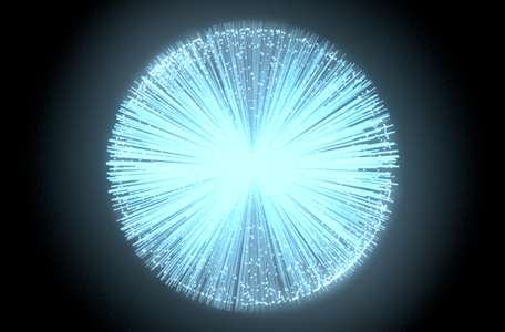

- Connect to Point: Trails from every point connect to a single common point denoted by the
Connection Point attribute.

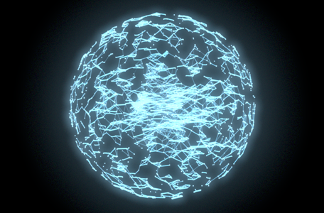

- Connect to Nearest: Trails are connected to the number of closest neighbouring points denoted by the
Count attribute.

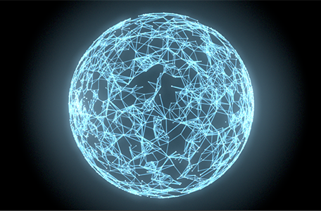

- Connect by Distance: Trails are connected between points within the specified
Search Radius.

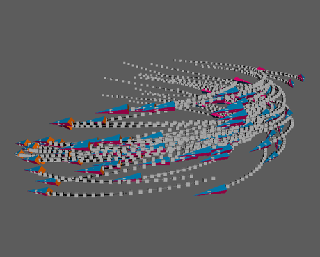

- Output Trail Points
- Creates a MASH point at each trail point when
Trails Mode is set to
Trails.
- Output Points to Nodes
- Determines the MASH networks to use when Output Trail Points is enabled. If multiple MASH networks are connected, the trails are assigned by point ID.
